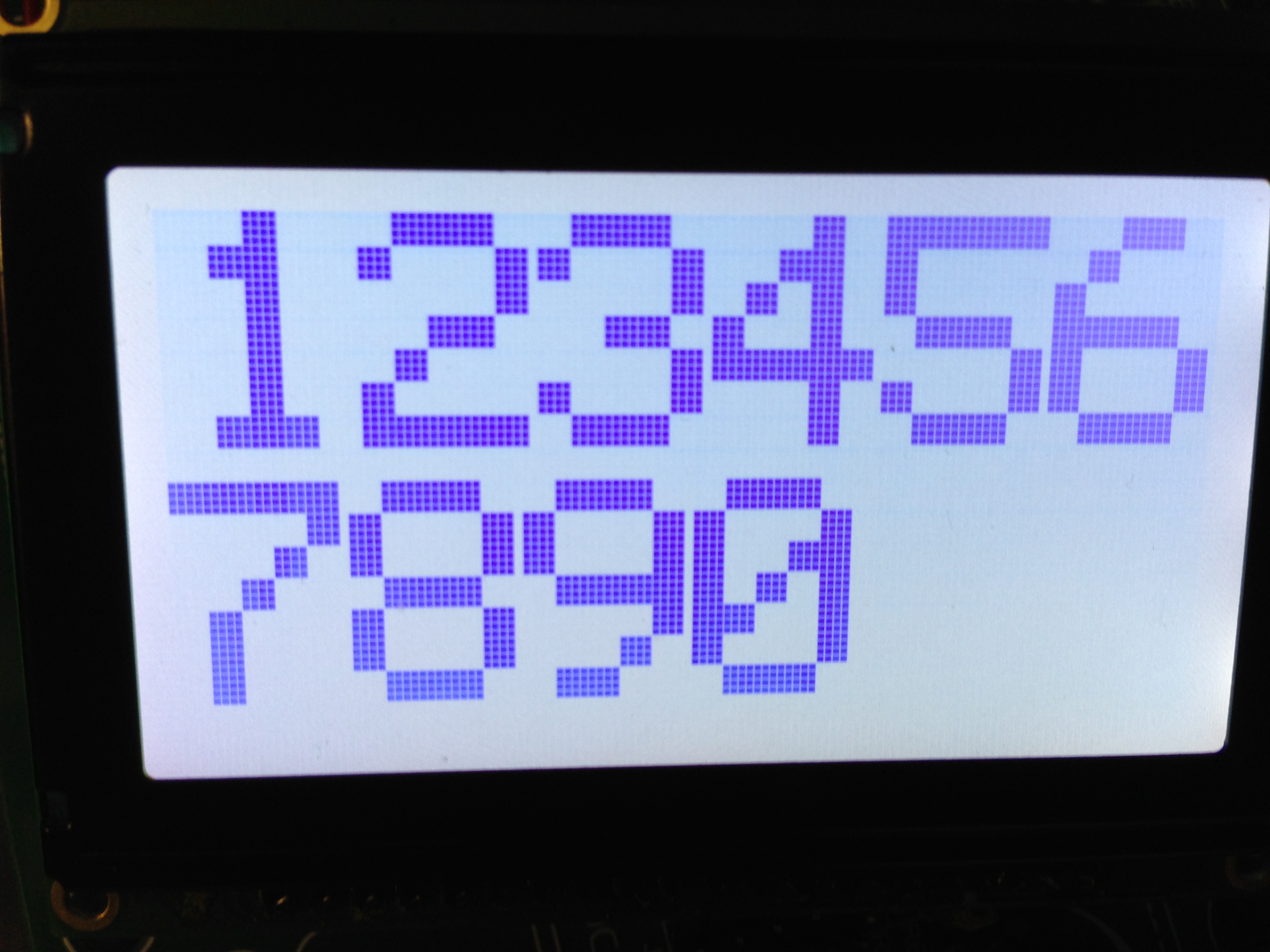

Hi Guys,
I am using this GLCD library (found on CCS forum) and it is working fine. But could I know, how can I change the font size from 8x5 to 32x20(or bigger than this). In order to do that I reckon, the other functions also need to be modified.
I got one function PutChar32x20 and I got the font for numeric value but I haven't got the alphabetic font for this function.Where Can I find the bigger font? I have tried yo use mickroElektronica GLCD font creator but output is completely different than the expected.
I have attached fonts_glcd and GLCD for your reference. I would also like mention that I .
Help is appreciated.
Cheers

Hello folks,
I have changed the size of font from 8x5 to 32x20 and everything working perfect. I have attached all the related file.
What I have done with the font of 8x5 size:
1. The code for Digit 1 is
0xFF,0xBD,0x80,0xBF,0xFF,0x55,0x55, // 49 1
2. As Mike mentioned in post #345 https://www.electro-tech-online.com/threads/unicorn-glcd-demo.30617/ that
The first character is the left hand column with the LSB at the top of the column. They're also stored inverted.
so the hex code for Digit 1 looks like as below:
1 1 0 1 1
1 0 0 1 1
1 1 0 1 1
1 1 0 1 1
1 1 0 1 1
1 1 0 1 1
1 0 0 0 1
1 1 1 1 1
3. write first bit 4 times in a row and column.
4. Final code will look like.
1 1 1 1 1 1 1 1 1 0 0 0 0 1 1 1 1 1 1 1 1
2 1 1 1 1 1 1 1 1 0 0 0 0 1 1 1 1 1 1 1 1
3 1 1 1 1 1 1 1 1 0 0 0 0 1 1 1 1 1 1 1 1
4 1 1 1 1 1 1 1 1 0 0 0 0 1 1 1 1 1 1 1 1
5 1 1 1 1 0 0 0 0 0 0 0 0 1 1 1 1 1 1 1 1
6 1 1 1 1 0 0 0 0 0 0 0 0 1 1 1 1 1 1 1 1
7 1 1 1 1 0 0 0 0 0 0 0 0 1 1 1 1 1 1 1 1
8 1 1 1 1 0 0 0 0 0 0 0 0 1 1 1 1 1 1 1 1
9 1 1 1 1 1 1 1 1 0 0 0 0 1 1 1 1 1 1 1 1
10 1 1 1 1 1 1 1 1 0 0 0 0 1 1 1 1 1 1 1 1
11 1 1 1 1 1 1 1 1 0 0 0 0 1 1 1 1 1 1 1 1
12 1 1 1 1 1 1 1 1 0 0 0 0 1 1 1 1 1 1 1 1
13 1 1 1 1 1 1 1 1 0 0 0 0 1 1 1 1 1 1 1 1
14 1 1 1 1 1 1 1 1 0 0 0 0 1 1 1 1 1 1 1 1
15 1 1 1 1 1 1 1 1 0 0 0 0 1 1 1 1 1 1 1 1
16 1 1 1 1 1 1 1 1 0 0 0 0 1 1 1 1 1 1 1 1
17 1 1 1 1 1 1 1 1 0 0 0 0 1 1 1 1 1 1 1 1
18 1 1 1 1 1 1 1 1 0 0 0 0 1 1 1 1 1 1 1 1
19 1 1 1 1 1 1 1 1 0 0 0 0 1 1 1 1 1 1 1 1
20 1 1 1 1 1 1 1 1 0 0 0 0 1 1 1 1 1 1 1 1
21 1 1 1 1 1 1 1 1 0 0 0 0 1 1 1 1 1 1 1 1
22 1 1 1 1 1 1 1 1 0 0 0 0 1 1 1 1 1 1 1 1
23 1 1 1 1 1 1 1 1 0 0 0 0 1 1 1 1 1 1 1 1
24 1 1 1 1 1 1 1 1 0 0 0 0 1 1 1 1 1 1 1 1
25 1 1 1 1 1 1 1 1 0 0 0 0 1 1 1 1 1 1 1 1
26 1 1 1 1 1 1 1 1 0 0 0 0 1 1 1 1 1 1 1 1
27 1 1 1 1 1 1 1 1 0 0 0 0 1 1 1 1 1 1 1 1
28 1 1 1 1 1 1 1 1 0 0 0 0 1 1 1 1 1 1 1 1
29 1 1 1 1 0 0 0 0 0 0 0 0 0 0 0 0 1 1 1 1
30 1 1 1 1 0 0 0 0 0 0 0 0 0 0 0 0 1 1 1 1
31 1 1 1 1 0 0 0 0 0 0 0 0 0 0 0 0 1 1 1 1
32 1 1 1 1 0 0 0 0 0 0 0 0 0 0 0 0 1 1 1 1
5. The PutChar32x20 and PutMessage32x20 functions are defined to print the character on the display.
Cheers
