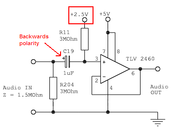

Hi, I know I'm joining this thread ridiculously late, but I have a question about this particular unity gain circuit. Does anyone know why it has to have TWO 9volt batteries? does the lm714 require dual supply rails or just need +18v? Would the circuit work with only one 18volt supply (wall wart)? If the lm714 DOES require two supply rails, could the circuit be adapted to work with, say, an lm386, which only needs one +9 to +12 volt supply?
Any opamp can be biased at half the supply voltage and use a single supply voltage.
An opamp can be connected for unity gain.
An LM386 is not an opamp, it is a power amplifier for a speaker. Its minimum allowed gain is about 9 and it is designed so the inputs can be at 0V. It already has negative feedback for a gain of 20.
Thanks for the quick reply, I had forgotten that the lm386 was not an opamp... Upon further searching, I found this site: http://www.e-basteln.de/harp/
Where he takes the existing circuit, and uses a TLV2371 opamp which only needs one positive power supply... I think that that seems like the best way to go...
He takes an opamp that works when its supply is as low as 5V and he biases its input at half the supply voltage like I said to do with any opamp. But most opamps don't work properly when their supply voltage is only 5V.
He also has the polarity of the input capacitor backwards.
