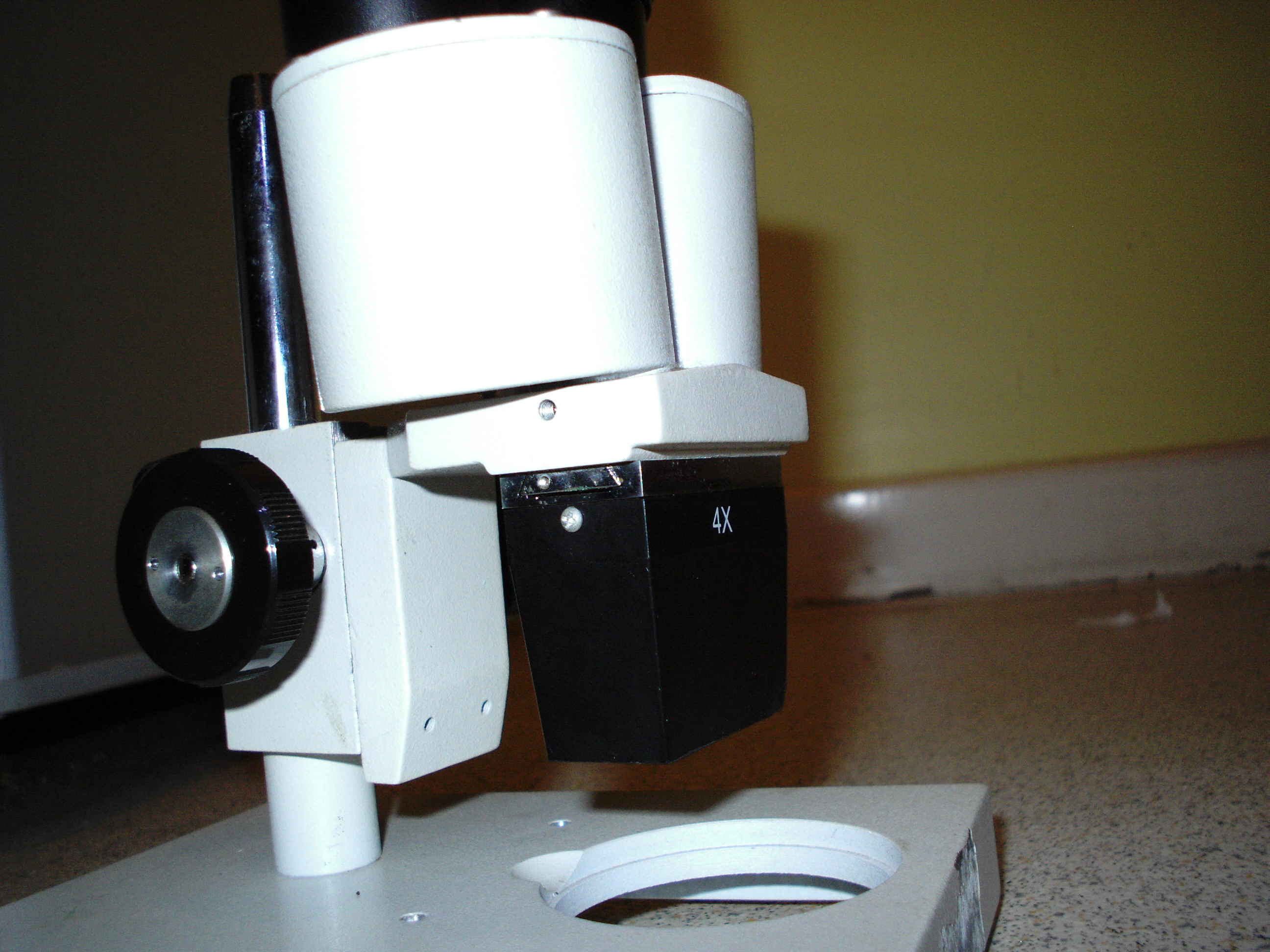

Yes, they are 5mm (or 6mm including the rim) and advertised as super bright (but don't they all!) white LED's of which I'd like to use as many as possible for best illumination and power efficiency. What are your hints and tips on that score?
Below is the 'scope in question and as you can see, has ample space for a string of LED's all around the black cover which measures 4.5cm by 2cm.

I suppose if you build that joule bandit circuit, the only thing left to optimize is to put reflectors around the LED... focus the light onto your specimen.
Reflectors are used with incandescent light bulbs because they shine all over the place. Most LEDs shine a narrow beam in only one direction so a reflector won't do anything.

Being impatient and carefree I tried an experiment using six LED's and a 9V PP3 battery. I made two blocks holding 3 LED's each. The LED's are wired in series and the blocks wired in parallel. ie each block receives 9V which is fed in series to 3 LED's.
It works at the moment but I don't know how long it'll last. What are the dangers? Too much draw draining the battery rapidly or too much power burning out the LED's?
What resistors are you using?
The current might be too high which will cause the LEDs to overheat.
It's also possible that the current is very low and the LEDs won't last long and will stop working when the voltage drops much below 9V.

A new 9V alkaline battery has enough current to instantly burn out three 2V red LEDs in series.
If the three LEDs are 3.2V white or blue ones then they will be very dim when the 9V battery is new and will not light when the battery is run down a little.
The reality is the battery is not new and the white ~3V LED's provide very good illumination at first glance. Going by what you're saying Uncle Scrooge, I won't burn out the LED's but might find the battery's won't last very long? What about two PP3's in parallel?
When a battery voltage runs down a little then the current (and brightness) of series LEDs without a current-limiting resistor will drop very quickly.
Two 9V batteries in parallel will last a little longer than double the life of a single battery.
