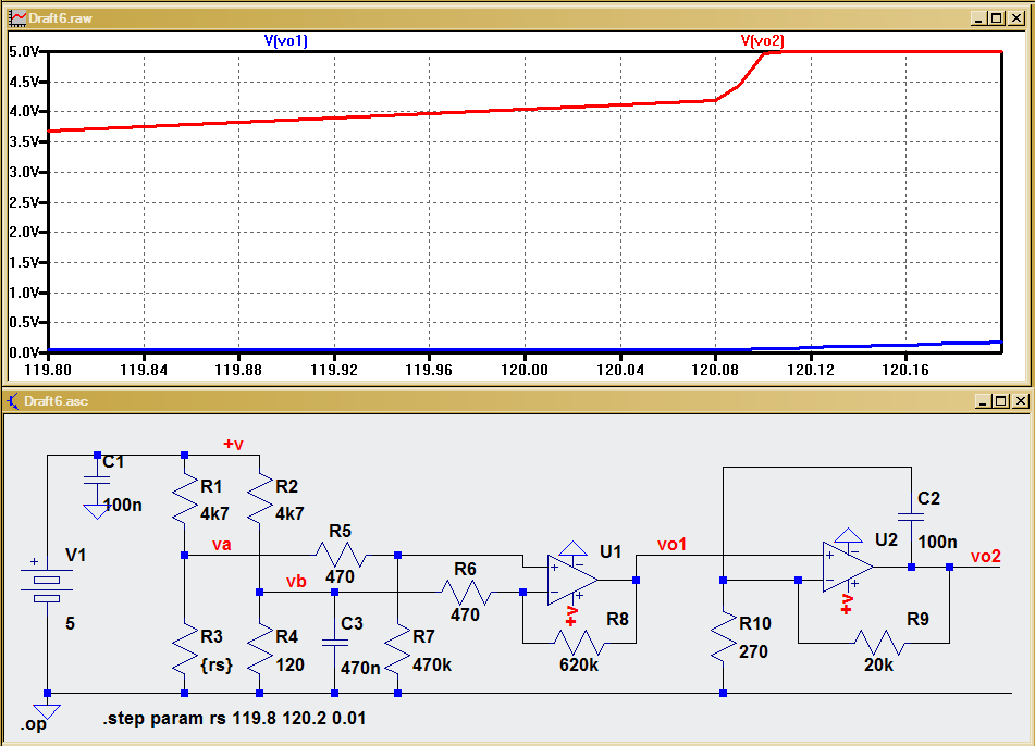

hi bee,
This is the output response of your circuit when using LTspice, the plot shows the problem that you explain.

Eric
What op amps are you using in your simulation, just some generic opamp or an MCP6296 which is according to its datasheet is rail to rail on input and output?
To what do you atribute the "step" in your simulation?
JimBs comments in RED
Eric

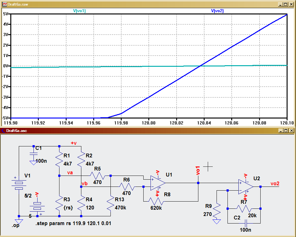

hi Jim.
The generic opa is set for rail to rail operation.[ and below 0v input]
I will look at the sim more closely to identify the step problem.
Do you use LTspice.? I could post the 'asc' files.
This modified circuit works OK.

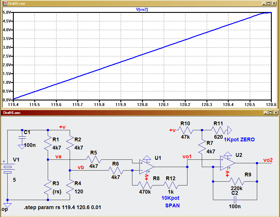

hi Jim,
To highlight the problem I have changed the 0V for the OPA's to -5V, so that the 'true' biassing state shows on the outputs.
I have tried a range of rail to rail OPA's with the same result.
If he trims the SG to 120R, the outputs are below zero.?
[The 4k7 and120R in the bridge I have set to 0.01%]
