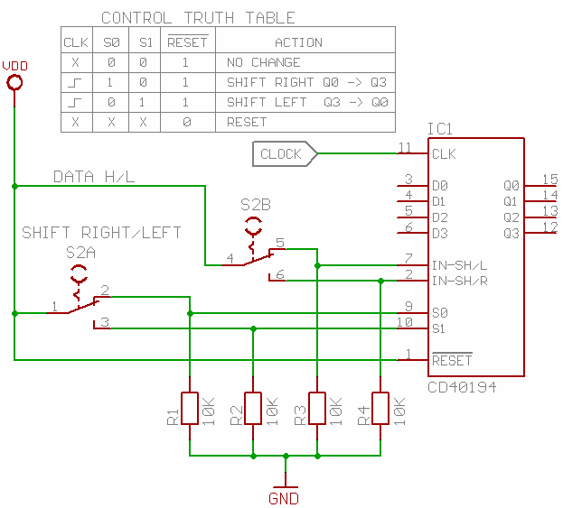

Hi Carl,
I looked up the 40194 data sheet but I don't understand some pin functions.
There are two inputs S0 and S1 determining the shift direction. There are also two inputs "shift left and shift right", which are not described in detail in the data sheet.
I attached a small circuit which should work according to the info obtained from the data sheet.
If you have any experience working with that chip, please advise. I will try to work out a "wired logic" logic circuit for the OP.
Kind regards
Hans

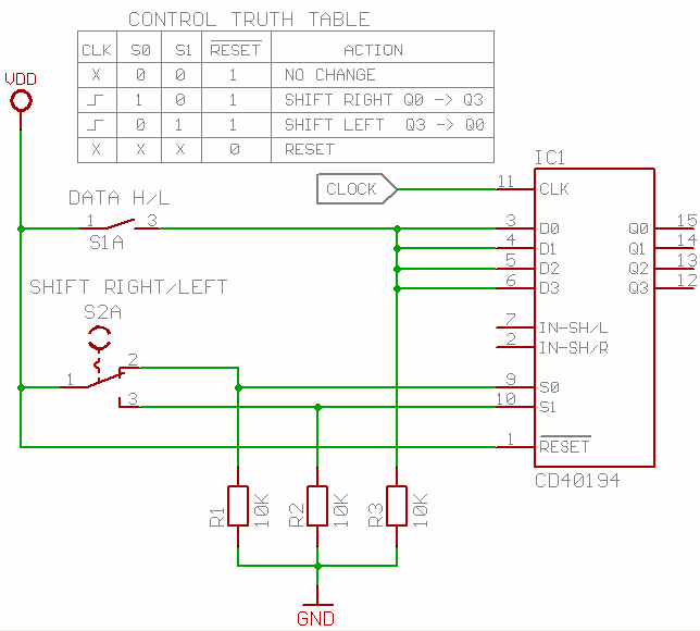

Would this also do?
Your second circuit is closer than the first. The "Shift Left" and "Shift Right" inputs are the serial data inputs for the serial shift. For this application you would tie SH/R high and SH/L low. That way when you select SO and S1 to "Shift Right" it will sequentially load a "1" into the FF registers QO, Q1, Q2, and Q3 for each clock pulse. When you select S0 and S1 to "Shift Left" it will sequentially load a "0" into Q3, Q2, Q1, and Q0. Thus you rather neatly have the desired sequence for the LED lights.
EDIT: To use more than one chip in series for more bits you connect Q3 of the first chip to SH/R of the second chip. You connect Q0 of the second chip to SH/L of the first chip. And so on for each additional chip. The first chip has SH/R tied high and the last chip has SH/L tied low.
If you envision the bits traveling through the shift register in either direction it should make sense. Does it?
