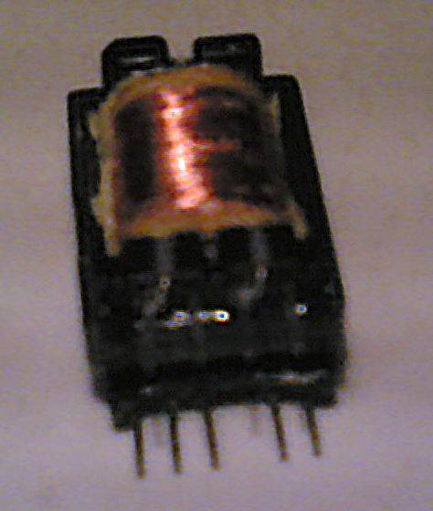

I found the part that is causing the whine noise.
I did it by using low power speaker shielded magnet. I used it plastic bag. And by holding it near every coild and small transformer (there are two of them) I discovered that if I hold it by one of them the noise becomes louder.
So I found the part that makes the noise.
I de soldered it and placed in laquer for a few coats. But that did not help, It still makes the same noise.
The part is listed as 430-0269 05523 FALCO.
My usps model is: BACK UPS PRO RS 500VA
Also knows as: BR500I
The battery is new and should not be considered as a problem source.

Looks like a transfomer to me. usually it's either the windings or the core vibration. It can often be fixed by dipping the whole thing in varnish or epoxy.
Even then you may not be able to do anything about it, if the natural conformal coating towards the center of the coil has developed a gap coating the outside won't do a thing. You'd have to completely rewind or replace the coil.
I do want to replate the thing. Can anyone give me any idea what part do I need? I can order from farnell or other site.
Not a clue.. sorry.
If you don't have the mfgr part number from the transformer it's just about impossible to guess it's specs. A switcher transformer has a lot of critical specs (I have designed quite a few) like turns ratio, primary inductance, leakage inductance, core flux density, etc and you have to know the input/output voltage and current to design it as well as the operating frequency.
It you are down to last option, you might try this:
Get some clear urethane spray coating (hardware store has it). Warm the transformer in the oven to maybe 150F (as hot as possible and still be able to hold it in your hands). Then hose the heck out of it with the urethane trying to get it to flow into the windings and core. Wipe the excess off the outside and let it dry. Might fix the noise.
