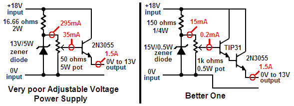

You can make a very poor 0V to 12V power supply with a 2N3055 transistor, a very high power 13V zener diode, a very high power resistor and a very high power low resistance potentiometer.
It makes a lot of heat is it is unloaded or if it is loaded.
Its output voltage is not regulated:
1) Its max output is 12.3V without a load and drops to about 11V at 1.5A.
2) Its half output is 5.8V without a load and drops to about 3.8V at 1.5A.

Add a transistor to the poor power supply then the zener diode can be a small one and the resistor and pot can also be small.
The output will not change as much when the load current changes and it can be adjusted from 0V to at least 13V at up to 1.5A.

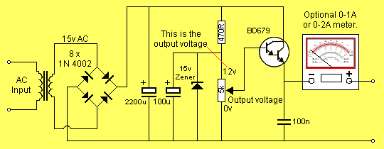

A BD679 darlington transistor will work fine in that power supply circuit. It is small so it will need a pretty big heatsink.
The circuit is not regulated, its output voltage changes when the load current changes. Is that OK?
can please define this diagram and give the calculations and working of BD679...
please...
have made two power supplies on is with LM317T and this BD679...

*got this circuit from yahoo answers!

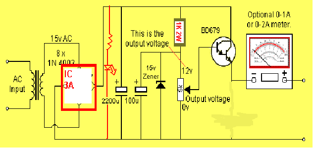

i have made changes in above diagram,
1. bridge IC rated 3A
2.instead of 470:ohm: , i am using 1000:ohm: 2W resistor
3. the pot is 10k:ohm: rated 5W
4. inserted a 1000:ohm: in series with led whole parallel with capacitor 2.2mF, as an indicator..
please give calculations and working of BD679... i have to submit it tomorrow and have to explain it as well.
For your new circuit:
Calculate the power dissipated in the 1k resistor. It is only 0.023W. You don't need a huge 2W resistor.
Calculate the power dissipated in your 10k pot. It is also only 0.023W. You don't need a huge 5W pot.
What else needs to be calculated?
The BD679 has a minimum current gain of 750 so at 1A its max base current is only 1.33mA.
The 10k trimput has a current of 1.5mA.
The 1k resistor has a current of 4.8mA.
The zener diode has a minimum current of only 2mA so the 1k resistor should be 220 ohms to 470 ohms.
