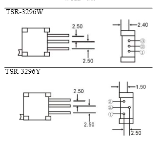

ok i just checked and pin 3 is going directly into pots pins 3&2 then pot pin 1 is going to pins 6 & 2 pin 6 also has + side of 10uf capacitor attached
That is good.

What is the full number on your RV. It should be like this:
3296-xxx-RRR-x
What is the code RRR. It should be 505
the only other number on it is this and the brand is SUNTAN
The code is 103 by the looks of it. That is a 10K VR. You need around 100K

Remove the VR completely so that there are no connections to the VR and none of the VR pins are connected together.
Measure with your meter set to 200K between pins 1 & 3. I bet the reading will be 10.
damn it i asked them for the pot you had in the diagram, ok i dont have a 100k resistor, i may be able to salvage one tho from something else like a power supply or something.
and yes it read 10
