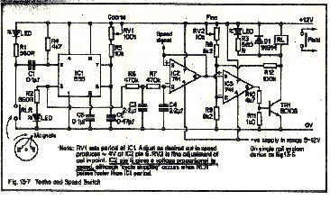

I want to get the speed of 2 excercise bicycles into a pc app with reasonable accuracy. I have used an ezio (www.ezio.com) board (a simple pic based analogue 2 digital convertor) to provide the interface. Connected to this is a proximity sensor on the back fork triggered by magnets on the wheel.
This works, but too roughly. I think the problem is that the sensors and the interface are both working out of sync. I think i need a sensor that changes state each time it is triggered instead of sending a quick pulse.

Wheel speed measurement
An old forum discussion on this subject went along this line...
Bike wheel with magnet on spoke; reed switch operated by magnet; f-to-v converter gives voltage proportional to speed. (See attachments)
Your current A-D converter is looking for a varying voltage to represent speed, your reed switch will only jump from 0v to +5v (or whatever). You need to either count these pulses over a fixed time (or time betweeen pulses) or produce an analogue signal proportional to speed (the attached drawings).
The LM2917 circuit was tested as OK :wink:

We have been counting the pulses and doing the maths at the pc end. Am i right in thinking that using the second circuit with the LM 2917 (£3 from maplin) I will continually get a variable voltage based on the frequency of pulses from reed switch. As the ezio board gives +5v will your circuit give a variable voltage in this range.

The output voltage range will depend on the R and C values you choose and the number of magnets on a wheel and the wheel's speed.
There is no reason why the circuit couldn't produce 0 to 5v, maybe limited with a zener diode to protect the IO card ?
