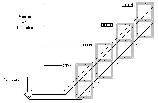

I unable to understand where should I use the BCD decoder(only one should be used) . Can you please give me an idea for the first design?
If the display needs to be multiplexed then you indeed require only 1 BCD decoder. The segments of each display are connected together (seg A of display 1 is connected to seg A of display 2, ...). And the resulting 7 lines are all driven by 1 BCD decoder.
To display a certain number (let's say 723), you put the data for the first display to the BCD decoder (a 7). But you only drive the common anode of the first display. So only the first display will show a '7'. Then you do the same for the other displays. Cycle this fast enough and it will seem as all displays are on simultaniously...

If all the segments of the LEDs are connected , then will all the LEDs not glow at a time ?
The displays are wired togheter so they will all show the same, but you only activate 1 display at a time. So, if you want to display the number 123 you put a '1' on the segment lines and only activate display 1, then you put a '2' on the segment lines but only activate display 2, and so on...
do this over and over again, more then 50 times a second, and it will look like all the displays are on at once.
try googling for 'display multiplexing'
each display needs 2 connections to make it light up, one to the segment you want lit, the other to the common anode pin. The displays will all get the same signal to the segment connections, but only the one you want lit will get the second "common anode" conection. This is what the BCD chip does. It completes the circuit so only one display lights up.
If you switch between displays fast enough, your eye cannot tell that the one display has gone out when the next one lights up, then the first one is turned on again.
Hi jaravind,
If all the segments of the LEDs are connected,
Well, they would, but the anodes are only fed
one group at a time.
Another reason for pulsing them like this, is
that LEDs can give a higher net light output
when driven in short bursts than continually.
I think this sort of 'rows and columns' is
called matrixing.
I hope the picture makes it clear.
Regards, John :)
