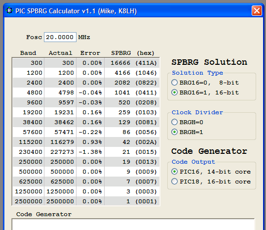

A 1.8% bit rate error shouldn't be a problem but if you think it might be then as an alternative to using a special crystal frequency you might consider using one of the newer PIC devices which have a 16 bit SPBRG clock divider chain instead of the 8 bit clock divider chain in the '628A. Using one of these devices with a 20 MHz clock, with BRG16 = 1, and BRGH = 1 yields a whopping 0.16% bit rate error for 38400 baud.

spbrg-calc-png.29592
