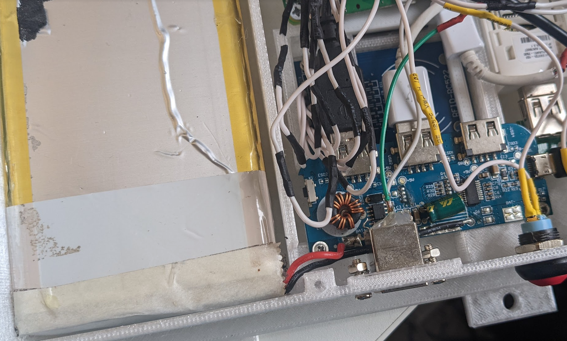

Thanks for the reply. Yes, this is the route I went down originally. I (carefully!) took apart a unit and then used that in the system. The issue I now have is that that unit is no longer available and I've based my 3D print around it. I would rather use a combination of components that are readily available that re-design my case around another brand of phone batter and have that then be discontinued again.
I've included an image below, showing how the current (but now unavailable) phone battery is embedded. It actually works really well.
That is a way cheaper unit and available. The adafruit board has some useful functions on board, like led outputs for 'charging', 'low battery' states which would be useful for my current application of this.

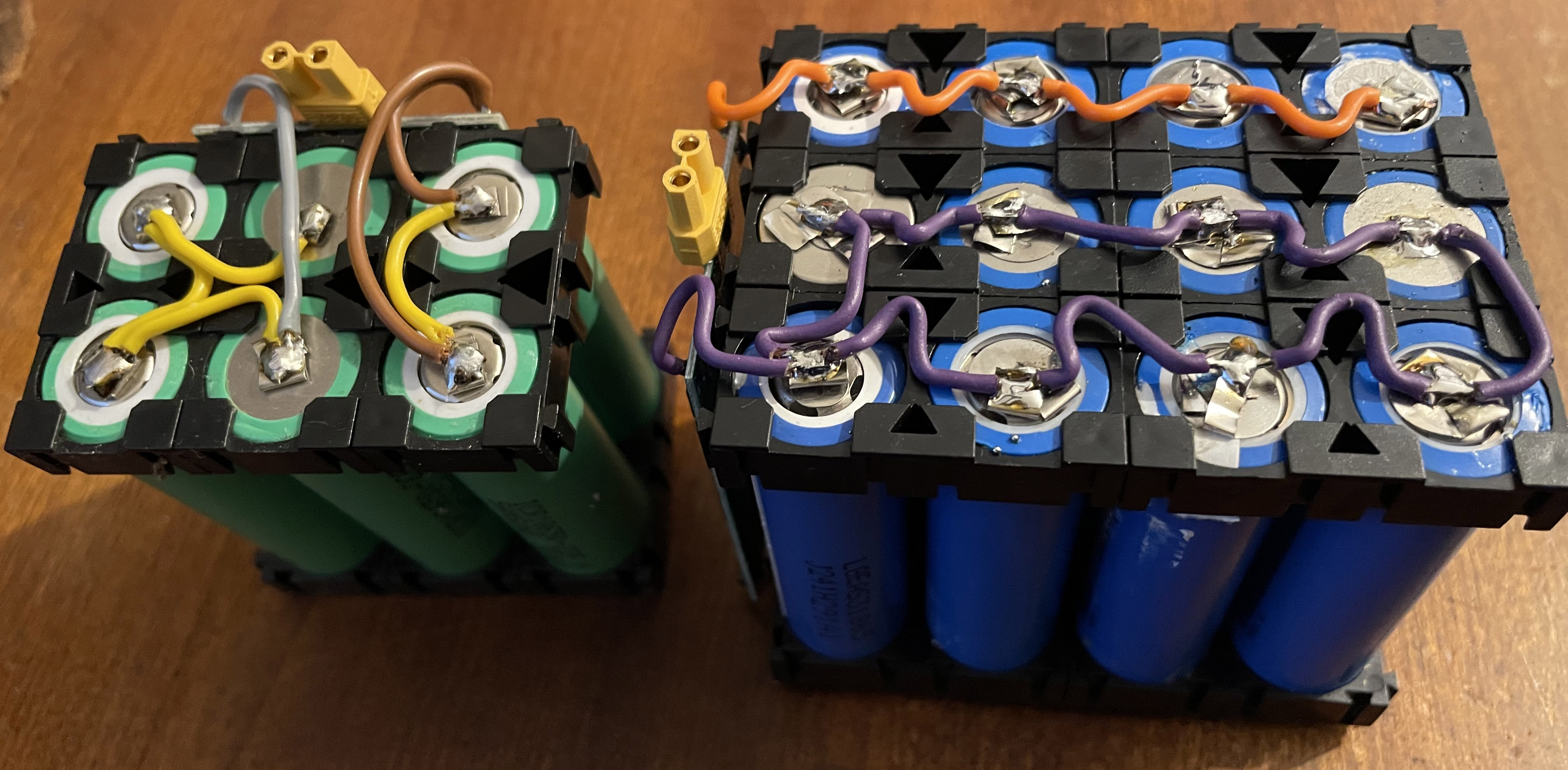

Also, if you want a good source of cheap but decent 18650 cells, look for new replacement 9 cell / 7800mAH laptop batteries on ebay - you can find them for less than £2 per cell and easily split them down.
eg.
Carefully split any series connecting strips at the centre with good cutters & fold the stubs back over the centre of the cell ends; it leaves you with cells that have "solder tags" at a fraction the cost of good quality commercial tagged cells.
I use loads of them..
