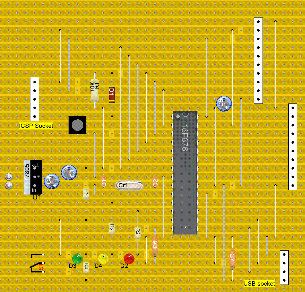

I recently built one from scratch, based on my 16F876 tutorial board.
Nice! I was thinking of building it myself aswell but it don't have alot of components in stock and therefore it would be more expensive than buying the finished thing.
