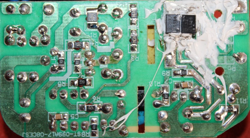

I've got a USB mains (100-240VAC) travel charger (Model ST-099A20) that has stopped working.
I've opened it up and traced it down to a faulty shottky diode. Or at least I think it's a schottky diode from the info I can find.
Its the 2 black SMD diodes by the white paste in the pic. I've removed them and one of them is shorted.
On the diode is

I've checked out the local electronics shop and cant find the same smd device.
My question is can I use something like a 1N5822 in its place?

If this is not suitable, can someone please recommend something I could use. It doesnt have to be a SMD.

What is the ouput current rating of that charger?
I would guess the 3A rating of the 1N5822 makes it a suitable candidate (even if the voltage rating isn't as high as the original).
Great - thanks. I'll try that and see how it goes.
Update: 1N5822 works like a bomb. As good as new :)
