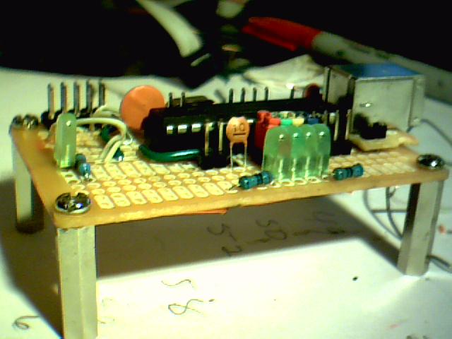

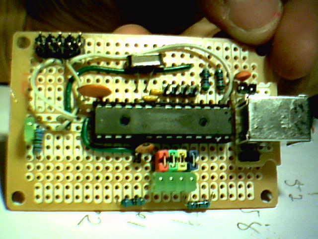

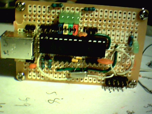

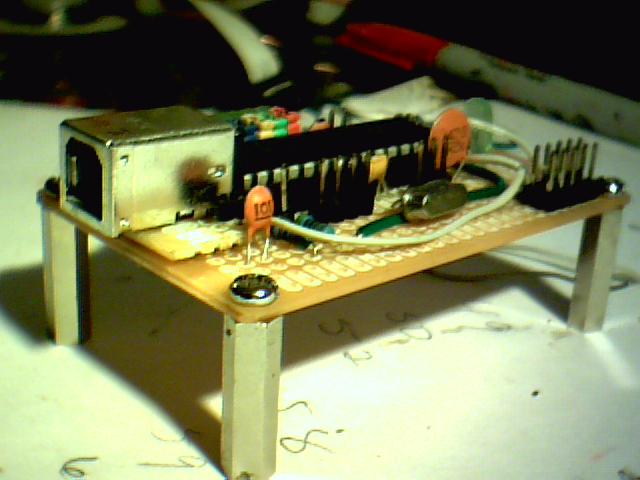

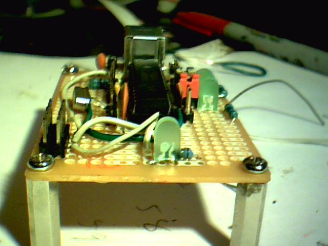

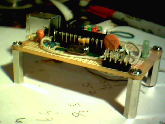

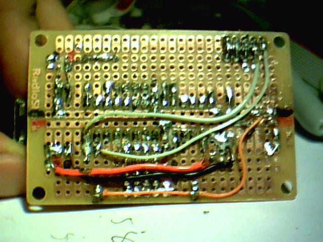

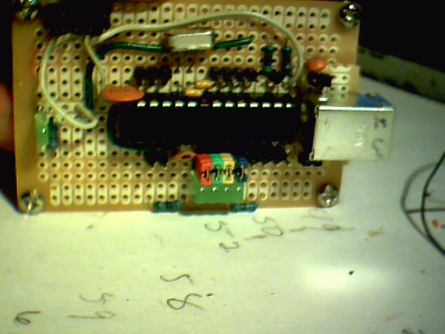

Just wanted to show my board ... dont have my printer yet to make custom PCB so used radioshack as usual.

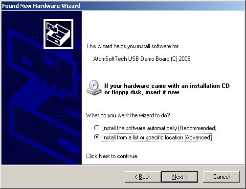

Here are many Pictures.. and some screen shots...
usbinstall-jpg.23424
RB4:0 have jumpers on them so you can remove some to use for non led purpose...
All usable pins are extruded (has a header) if pin is for use and CANNOT be used like D-/D+ no HEADER is used.

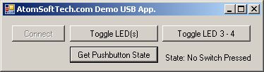

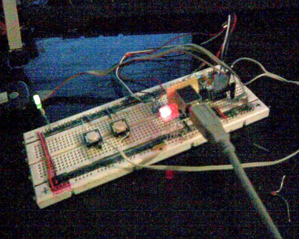

I added another button (now has 2 ) and control over the 2 extra LEDs i have on board.
Heres a screen shot of the app. and a pic of the breadboard.
