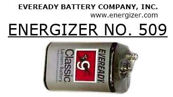

Not sure how you got that information from the Energizer site -- I didn't see it anywhere there. Eveready was the original company that came up with the Energizer tradename for their alkaline batteries much like Mallory came up with the Duracell tradename. I think that the alkaline battery industry was such that the new tradenames took over the companys' product lines and both broke off their alkaline line as independent companies such that you don't see Mallory associated with Duracell or Eveready associated with Energizer. The only time I've seen "Eveready" products (used to have a cat jumping through the "hole" in a 9 for a logo) were as regular carbon-zinc cells made in China and sold in dollar stores. I'm not ever sure that that "Eveready" is the same company as it was in 1960.
A few obsolete Eveready carbon-zinc battery datasheets are still online at Energizer.
Here is a sample:
