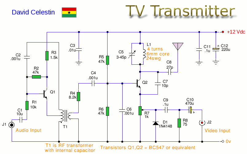

I purchase a few 5.5 MHz coils from **broken link removed** in order to attempt building a PAL B/G TV transmitter following the instruction at this website **broken link removed**. The transmitter diagram is below:
The exact item which I purchased is "5.5 MHz IF coil, green, design G, square 7 mm". The website offers various designs for various transformer frequencies. However for 5.5 MHz, design G is the only available design:
I completed soldering the circuit on a stripboard and get the video section work without major issues. Well, the picture always rolls (vertical hold issues?) no matter how I adjust the trimmer for video modulation but I believe it is due to the incomplete circuit. The transmission is also very sensitive to the antenna position but I believe I can always adjust it later.

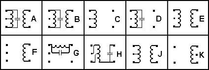

However, when I started to solder the IF transformer for the audio part (5.5 MHz is the audio subcarrier frequency for PAL B/G), I realized that my transformer is of design G (two pins on each side (primary/secondary) with a tuning capacitor on the primary side), while I need design A (three pins on primary side, 2 pins on secondary side with capacitor on primary side) in order to build this TV transmitter.
Any ideas how I can use the IF can I bought to complete this circuit, perhaps with some circuit modification?
The oscillator type requires a tapped primary, so you can't use the transformer you have.
There is an oscillator type that uses two capacitors in series, to create a 'tap' that works in the same way - but you would need to redesign the circuit, and remove the existing capacitor in the IF transformer.
However, it's only for sound, so won't be affecting your picture, and there seems little point messing about with the sound until you get the main part working properly - if you connect R4 to ground, then that totally removes the audio part, so get the design working like that first - building it on stripboard means it might not work, unless your layout is suitable, the capacitance of the stripboard is substantial at the frequencies in question (although FAR, FAR better than attempting it on breadboard).

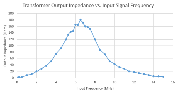

Yesterday, I salvaged what looks like an IF transformer from an old VCR. Using a multimeter to measure resistance I was able to identify the primary and secondary sides, with 3 pins on each side. I follow the advice I get here https://forum.allaboutcircuits.com/showthread.php?t=37161 to measure the output impedance of the transformer at different frequency:
1. Feed a sine wave of reasonable frequency and peak-to-peak amplitude to the VCR (I used 0.25-15MHz, 2V peak-to-peak from my function generator)
2. With no load connected, measure the no-load output voltage (Vo)
3. With a reasonable load connected (< 100 Ohm, I used 47 Ohm), measure the output voltage with load (VL)
The output impedance is: Zo = RL * (Vo/VL - 1)

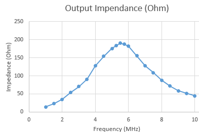

I then plotted the graph of output impedance vs. frequency in Excel and notice the frequency at which the impedance is the largest. After some trials and errors I was able to determine 2 sets of pin combinations on the transformer, which will result in a peak frequency of 5.5 MHz and 6.5 MHz respectively. See my graph below:
This makes sense (to me) since the transformer which I salvage was from the RF box which has a switch to toggle between PAL B/G and PAL D/K (which uses 5.5 MHz and 6.5 MHz audio subcarrier frequency respectively). Is this the correct way to determine the frequency, or is there a better way?

As regards measuring the resonance frequency, with reference to the Celestin circuit schematic: (a) short connector J1, so that the free end of C1 is at ground potential (b) connect one terminal of your scope or frequency counter between the junction of T1's secondary & R4 and the other terminal to ground (c) turn the inductor slug of T1 with the appropriate Toko coil adjustment tool (BEC should have this too, see under ceramic trimtools), until you zero in on 5.5 MHz.

Meanwhile what do you think about the method that I use to find out the resonance frequency by finding the output impedance? Is it correct? The result makes sense to me, but just need some confirmation from some experts just to be sure :)
Because of the detuning effects of transistor (and pcb layout) parasitic capacitances and to a lesser extent, inductances, it is best not to measure the resonance frequency of a tank circuit in isolation. This is why I suggested that you adjust for resonance in-circuit, with all the parasitics in place.

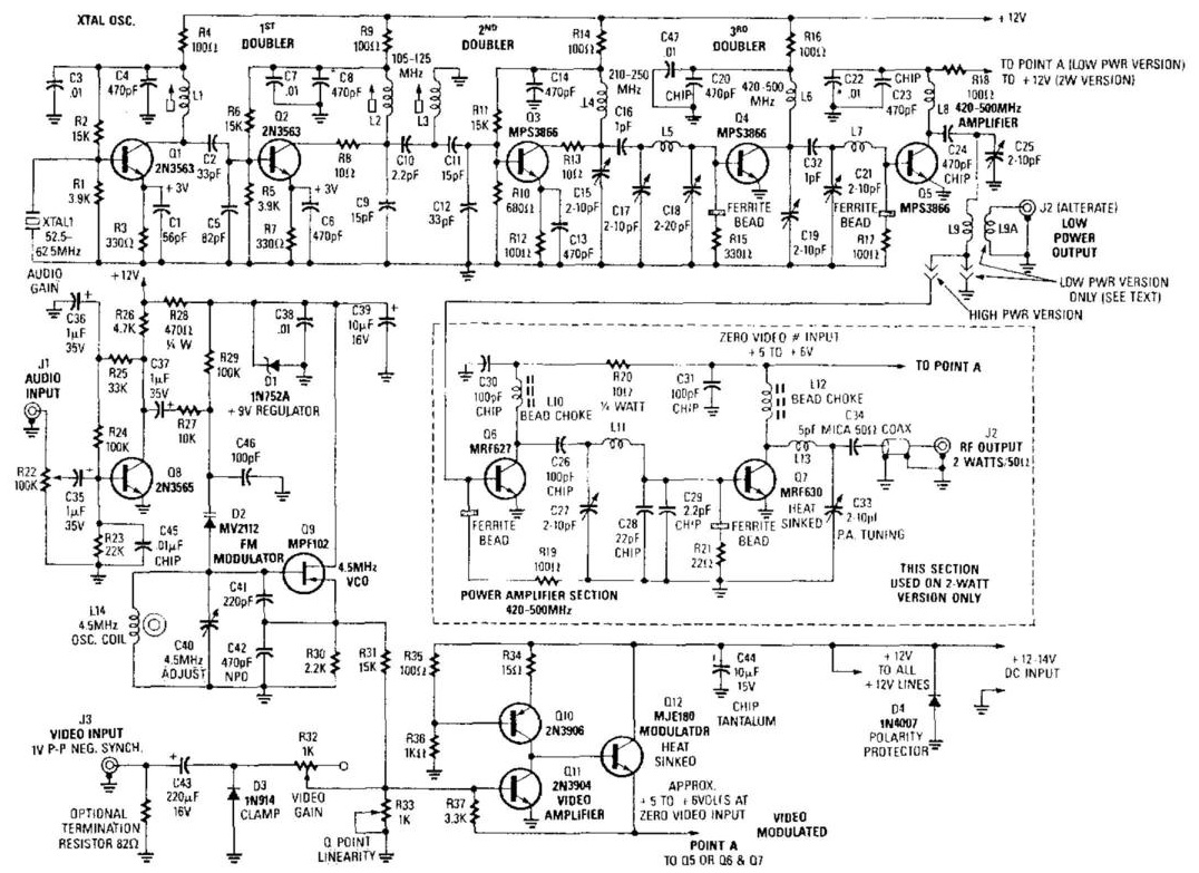

I have attached a circuit that is for 440Mhz , you can get the idea how to modulate sound on FM and mix with video and modulate carier frequency. I made one working transmitter long before and it gave good sound and picture quality. you can use part of your circuit (only oscilator & an amplifier) from what you have and use part of this (for audio in video) to make a working one.
There is another way to make transmitters by using only video and sound on FM sperated at 5.5 MHz for PAL. say if your frequency is 200MHz video them you have to have a normal FM modulator at 205.5 MHz and transmit using seperate antenna. I have seen some commercial transmitters having this concept.
Thanks for the circuit diagram. Let me spend some time studying it.
