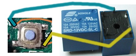

Alright correction. This is the type of switch i will be connecting to:
When i connect those points shown in the picture together the PC starts up. Holding the wire on them for a couple seconds turns it right back off.
Would the same setup be needed for this as well?
David
I just checked with a voltmeter those 2 points. When the motherboard is OFF it reads around 2.96v (So i'm going to call that 3v) and when i push the button down it goes to 0v. Releasing the button makes it go back to 2.96v (3v).

OK im going to switch gears here. I got a 5v relay that i will now be using.
I hooked it up and it triggers the relay closed when the digital output is high. And i have it feeding a gnd to the middle and the output pin on the relay is reading 0v. However when i hook that end up to one side of the switch and the other side to the arduino gnd it does not trigger the motherboard on once the relay is closed.
Fixed by doing the following:
