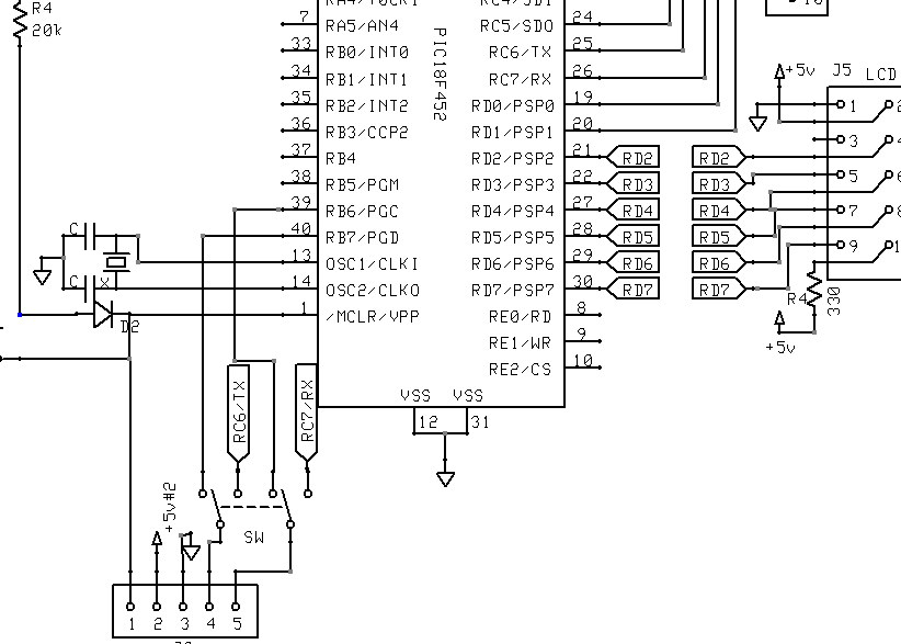

Using the Junebug to communicate via the UART to a daughter board(target project )
How to proceed?
setup - target is an 18F1320 or 18F452.
in order to use the USART do I just connect the RX and TX pins of the target to the Con 3 header or is it possible to use the ICSP header cable and a dip switch to connect the RX/TX ports.
In several schematics I see a 6 pin header used for UART - INT1, +5V, GRD, TX, RX, INT2
Any suggestions on connections
This is what I am wondering about connections
Want to build a development board that has an 18 pin and 40 pin sockets for target PICs, Board to have female sockets for jumpers from development board to bread board as well as a header to connect an LCD daughter board.
Want to be able to use the UART to debug code but need method to enable communication.
This is what my idea is. Is this feasible?

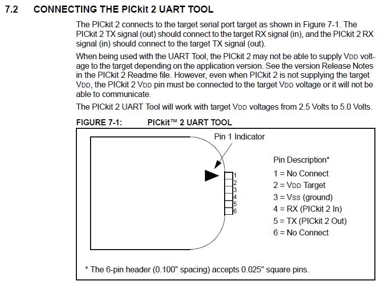

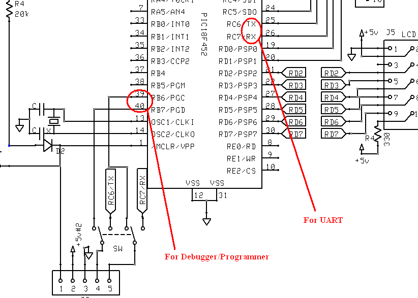

Hi, Mr Deb, the PICKIT2 users guide says you are only supposed to connect the VSS(GND), VDD, TX and RX pins with the PICKIT2( PG#69). Also, the power pins are necessary. If you are going to use the PICKIT2 UART Tool for debugging only, than why use the UART tool, why not the debugging tool itself? Also just looked at the schematic, in order to use the PICKIT2s UART tool, the PICKIT2 pins are to be connected to the TX, RX pins of the target chip in addition to the power pins. So according to your schematic you are not making connections for the UART Tool.

going to use the Junebug, not a Pickit2. Then using the ISCP header to supply power and ground.
If you look at a schematic for the Junebug I think I decipher that the proposed switch will work. The dip switch ciontrols the ICSP header for onboard PIC or off board target PIC.
Hi MrDEB, sorry i misread the schematic, the DIP switch will work( a somewhat similar procedure is done by SW6 in the Junebug). If by the Bold statement you mean that external supply will not be provided, I quote the PICKIT2(Junebug) user guide.
"When being used with the UART Tool, the PICkit 2 may not be able to supply VDD voltage
to the target depending on the application version. See the version Release Notes
in the PICkit 2 Readme file.However, even when PICkit 2 is not supplying the target
VDD, the PICkit 2 VDD pin must be connected to the target VDD voltage or it will not be
able to communicate."
So if you are not supplying external power, you need to go through the release notes, and if you are supplying external power than the Junebug power pins need to be connected as well. I say this because i needed to use external supply when i used the Junebug (PICKIT2) UART Tool.
