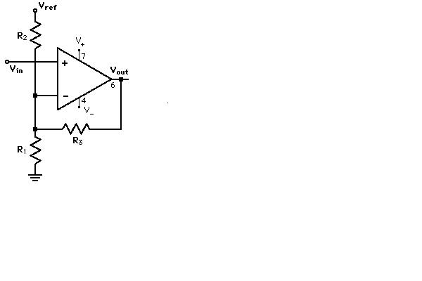

Im using an LM324. set up like this
That circuit is connected as NI amplifier,
ie with negative feedback [output to INV input].
For a schmitt, you require positive feedback [output to NI input], the value of the feedback resistor will set the 'hysteresis' of the circuit.
The circuitt you require, is a Comparator, OPA's dont make the best comparators.
Did you look at the LM393 data, it does explain hysteresis..:)
Ok yea i see what i did wrong. But im only given a LM124/224/324/2902 to use. i understand now that the feedback resistor controls the hystersis. But isn't that circuit a comparator?? Sorry getting a bit confused. :confused:
Thanks :)
Thanks :)
Yes its a Comparator, but isnt that what you need to convert the analog signal to digital.?:)
Post some details, ie: whats the range of input voltages, what output voltage, whats the application/assignment..????

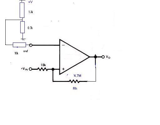

The blue text is correct.
The Vref is usually set by two resistors forming a potential divider from the +Vsupply to the 0V.
Its a good idea while you are testing, to add a variable resistor in series with two fixed resistors.
Something like this drawing.
REMEMBER: the LM324 OPA does not make a good comparator..
Does this look better i had a bit of problem using my first set-up. Does this look better to you?
I have changed the value of the resistors, they were too low.
Also the 10K from Vref is not required, but I usually use a 470R.
Why have you deleted the Rh hysteresis set pot,??
Otherwise looks OK.:)
