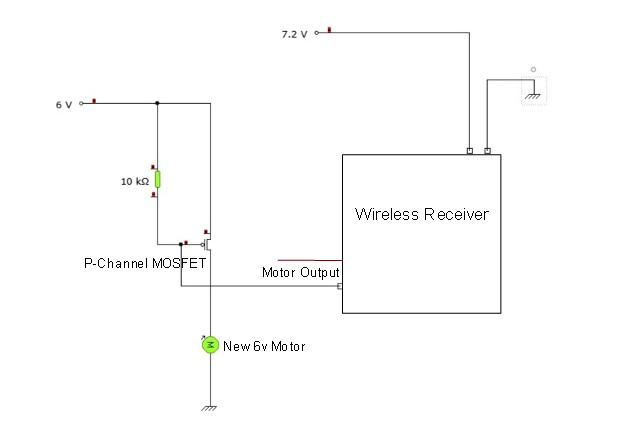

Greetings, this one is prob a no brainer, but it sure has me stumped at the moment.
Attached is a diagram of what I'm trying to do, but it doesnt quite work. I'm using a wireless receiver to power a model truck I'm custom building. The receiver used to power a motor, but of much smaller amp load then I am wanting to use.
The diagram shows a test I was trying on the bench, which worked with a smaller motor, but not when i attached the actual motor I'm trying to use.
The Receiver motor outs are this:
Red is connected directly to positive voltage in
Black pulls low as throttle goes up, giving speed control from 0 to100%

The usual lack of info. Can't answer your question without the MOSFET model number and the current draw of the actual motor.
Oh ya, I remembered what I forgot in the middle of my hot shower.
The MOSFET is a IRF4905.
The motor is actually two 6v motors in parallel from a Meccano building set. I wouldnt think the amp draw would be that much.
The circuit is producing, giving me speed control, but VERY MUCH under powered. The two 6v motors wont even move, they just sing.
Can you measure all the voltages when it's trying to drive the motors (including the supply)? That will help isolate the problem.
The problem could be the MOSFET. It requires a Vgs of 10V for full turn-on and you are only applying 6V. You may need to use a logic-level type MOSFET which fully turns on at a Vgs of 5V or less.

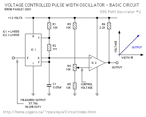

From further testing, I dont think this will work. Somehow I need to make the receivers motor output run a PWM, which can in turn hook to an IRF530, as shown in link below, but without the 100k pot
If you Google "voltage controlled PWM" you should get some useful hits.
I found this one, but I cant explain Pin 3 on the 555, or what the control voltage on IC2 is referring to, could it be asking for a 10k pot?
Pin 3 is the usual output pin of the 555. It is used here only to monitor the 555 operation (optional). Here, pins 2 and 6 are instead used as the output, providing a sawtooth wave as one input to the op-amp, the other input being a control voltage (DC threshold level) set by the 10k pot. When the sawtooth crosses the threshold the op-amp output switches from one supply rail to the other. The result is a square wave with a pulse width dependent on the control voltage.
