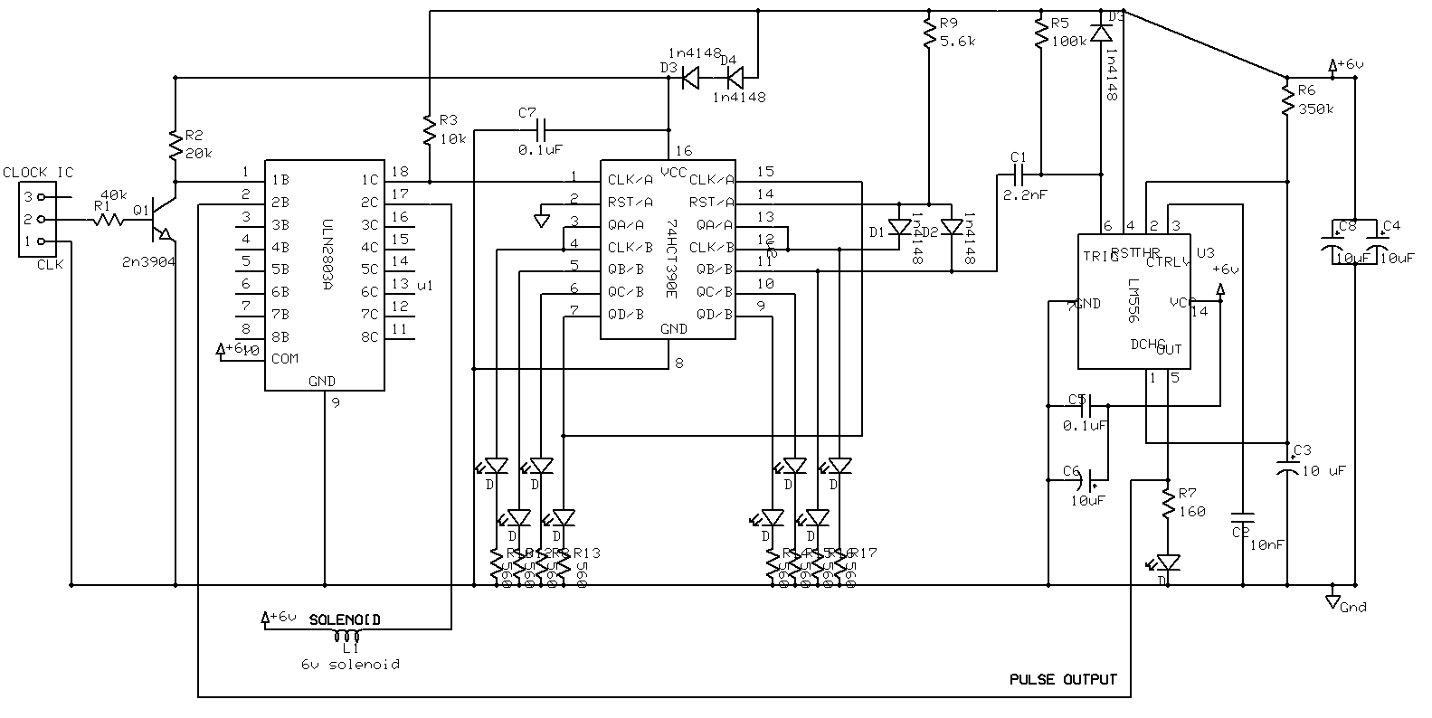

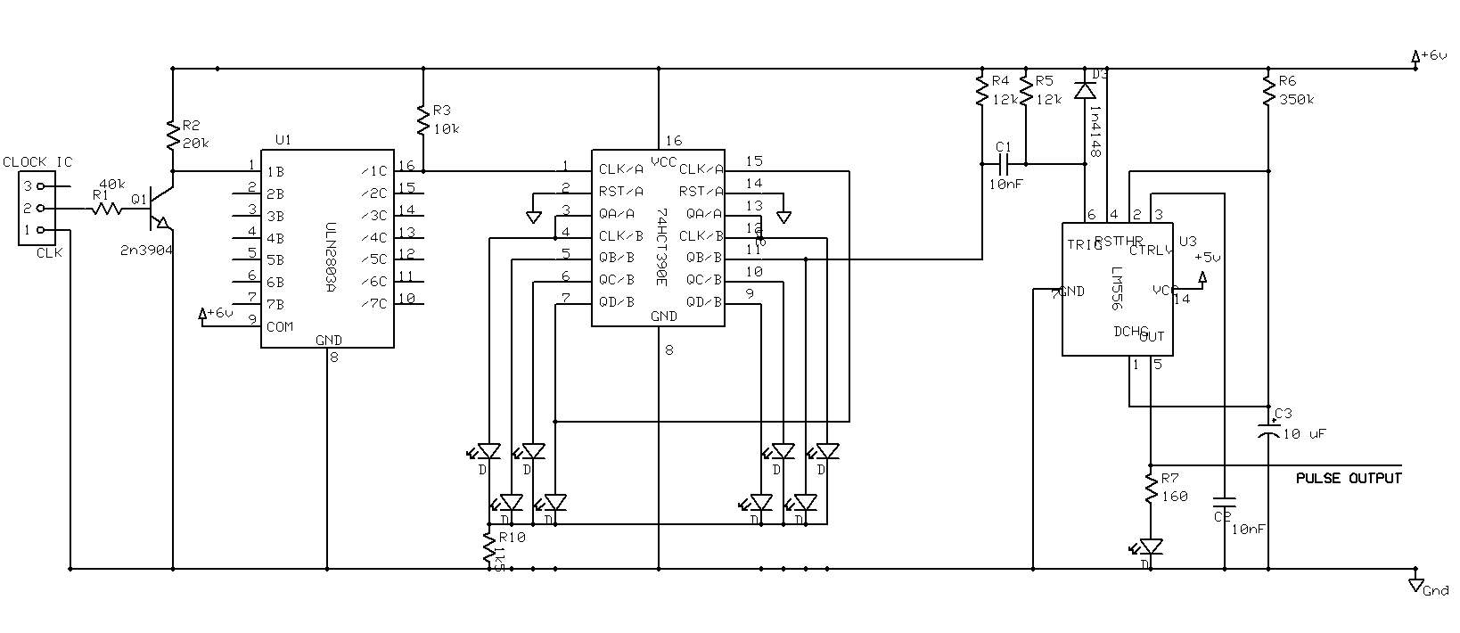

Ok, I have done that, but am running low on parts, so
R9 is 5.6k rather than your suggested 10k
c1 is 2.2nF rather than your suggested 1nF. The first diagram shows the circuit as it stands:

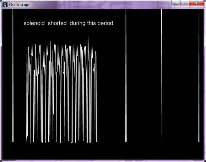

This exhibits the same problem as previously, where the power to the counter is disrupted when the solenoid is on. I don't think it is a problem to do with the 555 section, because it occurs even when that whole section is disconnected and unpowered. I can prompt the behaviour by shorting the solenoid to ground, energising it. As long as it's shorted, the counter races. osc3.gif (the clock in to the counter) and osc4.gifthe supply voltage to the counter.

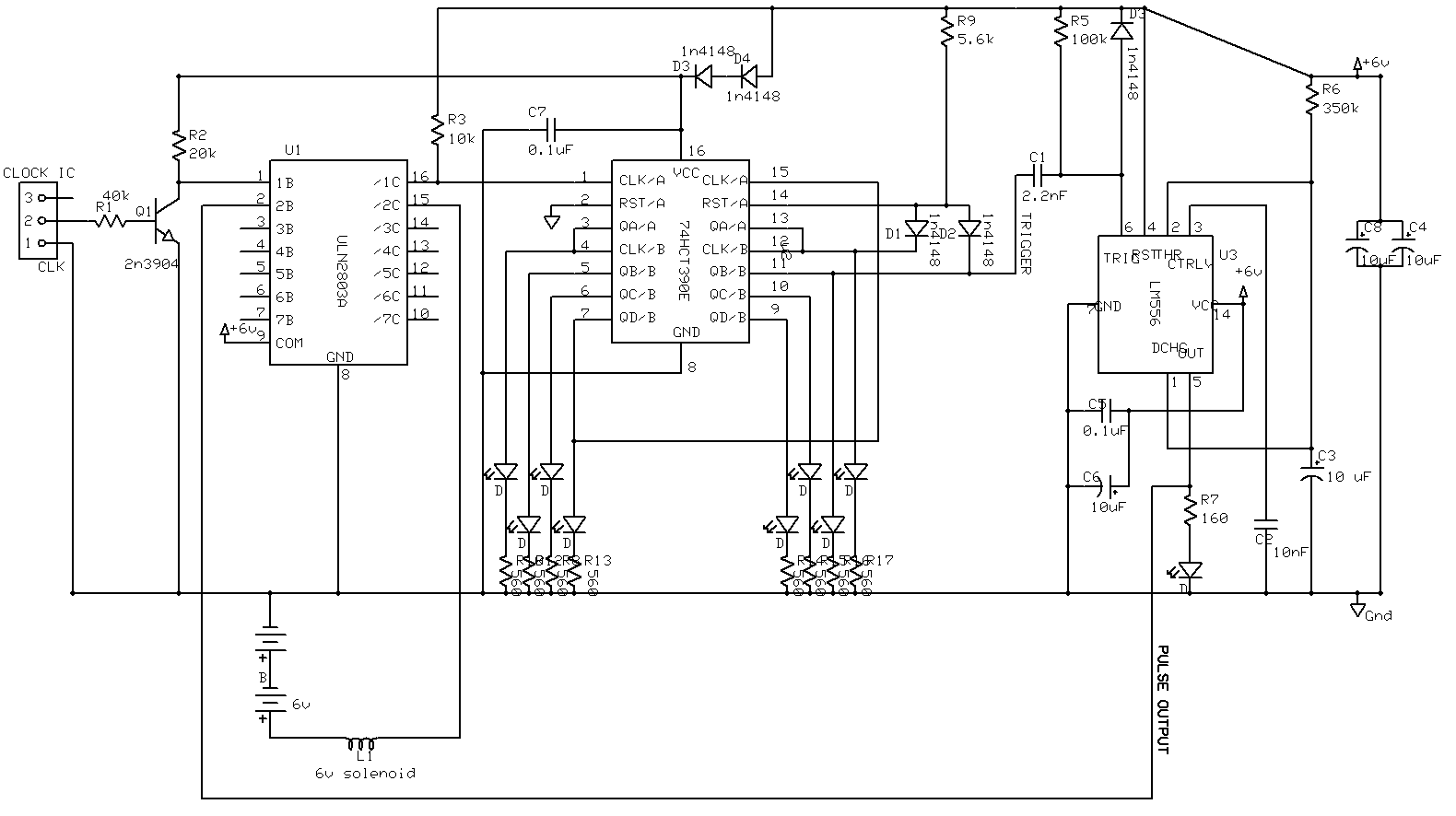

I've tried another circuit: linearclock3a.gif
that is just the above circuit but with a set of batteries (common ground) for the powering the solenoid. That works fine, every time, without affecting the power to the counter: Rejoicing etc.
Ok, so my problem is decoupling the solenoid power supply from the counter supply, I think? At the moment, I have two 10uF electrolytic in parallel between the +v and ground, which is far from the 47uF that was specified on my diagram for the 555 portion (at **broken link removed**) because I didn't have any more bigger capacitors spare.
Is it worth me beefing that up? Even running with three 10uF in parallel doesn't seem to make any difference to the shapes of the supply graph or the clock graph. Does it matter that they are polarised electrolytic caps? I have also tried adding a 10uF in parallel with the 0.1uF cap on the supply to the counter, without being able to detect any difference in voltage.

I'll work on your problem after you tell us why your ULN2803 pin numbers are wrong.
Yikes, really sorry Ron, folks, I had a 2003a (DIP-16) in my schematic software and had changed the name because it didn't have a 2803 in the library! And I got caught up with making the rest that I never went back to change the part. Specially since visually it married up just fine.
The exact model is https://www.st.com/stonline/products/literature/ds/1536.pdf

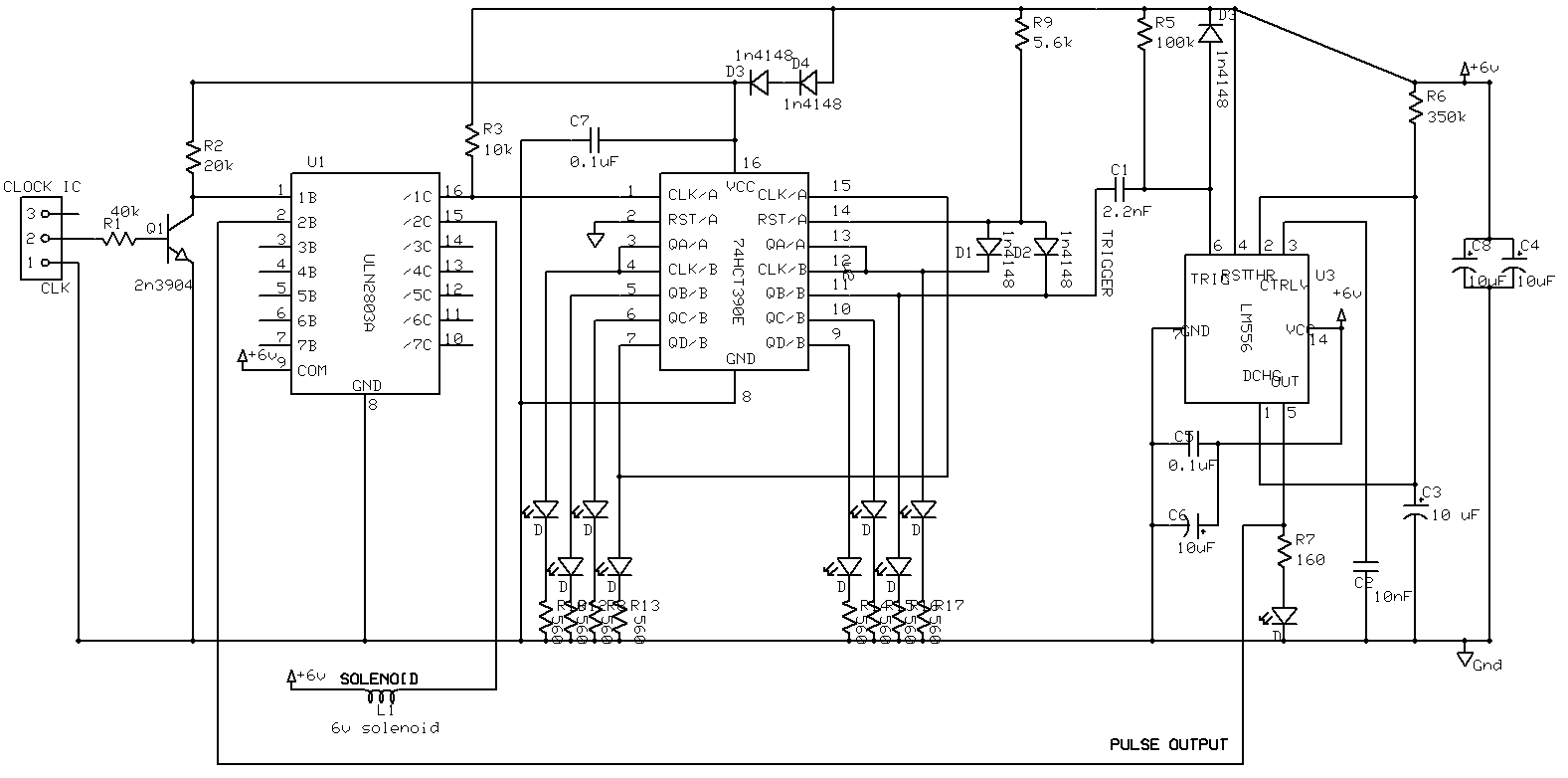

Very sorry about the confusion this caused.. hopefully it doesn't have much significance for the circuit. Here's a fixed version:

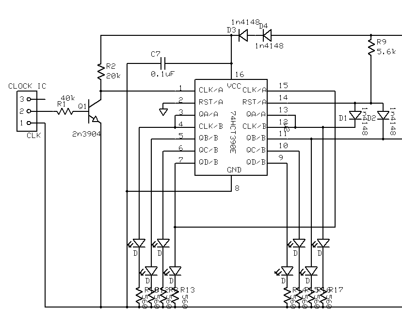

You've got the clocking circuit a little screwed up, and furthermore I think that the 2803's crappy logic low level may be the cause of your problem. Attach is a partial schematic, with the proposed clock buffer change.

IMHO, a MOSFET would be a better solenoid driver than a ULN2803A. You would also need a resistor and a diode, but with a 6V relay, you are probably only getting about 5V across it, due to the saturation voltage of the 2803. With the proper MOSFET, the voltage loss could be a few tens of millivolts.
The relay is probably designed to pull in with less than 5V across it, but it just seems like it would be more reliable with the full 6V across it.

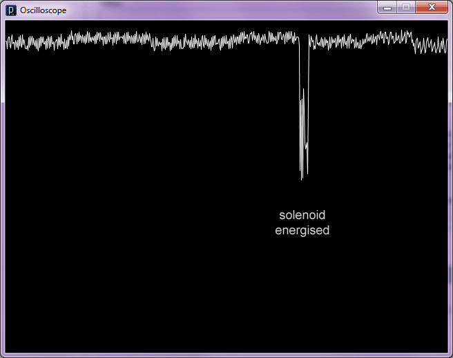

You know, I think you are absolutely right! Because I've just made that change and it works perfectly now! Looking at a graph of the supply voltage, there's still a big drop whenever the solenoid is on (as you'd expect I guess), but it doesn't affect the counter at all. That's brilliant.

As a half amp switch, 2N2222 is marginal, but should work. 2N3904 runs out of breath at about 100mA. Your discrete Darlington saturation voltage won't be any better than the ULN2803A.
The clock input circuit may have rise and fall time issues. You can improve the falling (active clock) edge by changing the base resistor to 10k, but the 2N3904 will always be faster than the 2N2222, all other things being equal. Your problems may be due to the long wires and high stray capacitance in your breadboard. Wires are antennas and inductors. The longer they are, the more likely you are to have problems.
Rapid has an N-channel logic level MOSFET, **broken link removed**, which you should be able to drive directly from the 556. Connect the 556 output to a resistor (47 to 100 ohms, not critical). Connect the other end to the gate. Connect the source to GND, and the drain to the solenoid. Be sure to connect a diode (1N400x) across the solenoid, cathode to +6V.
