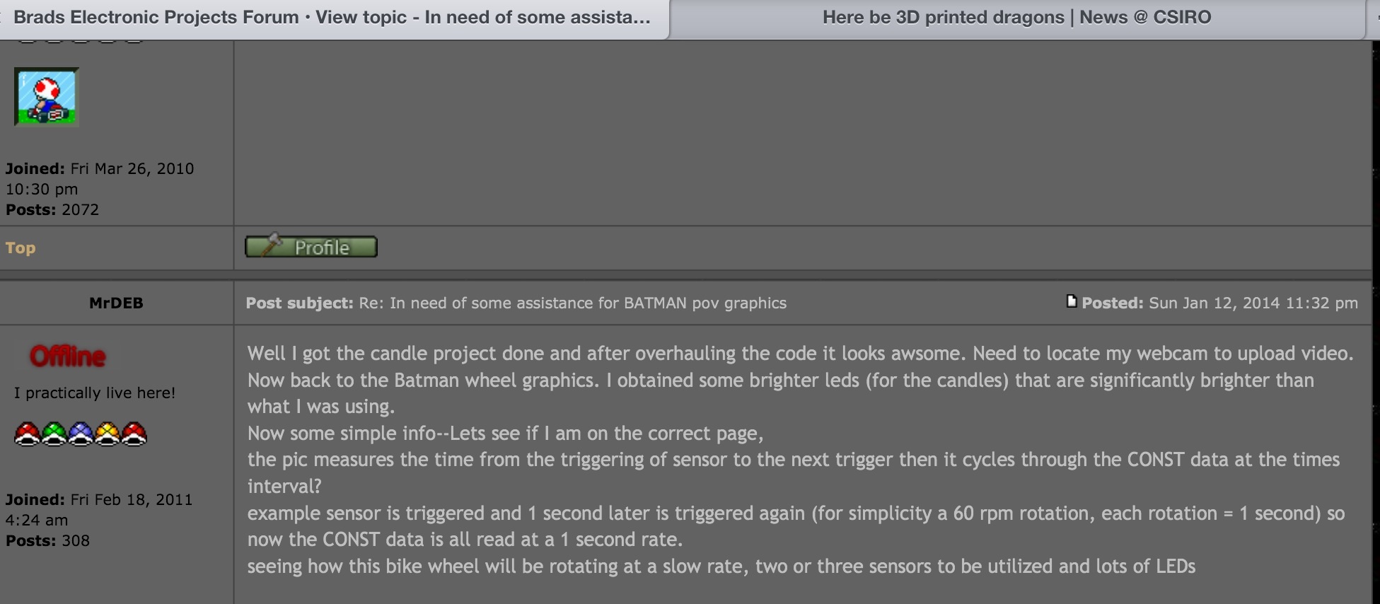

I have not followed the thread, but I agree with you. In a large project you concentrate just to "get things done". A simple hobby project really gives you the opportunity to dig deep into specific details.
...I never posted my final code so how can you determine if nothing was learned....
True statement that.
