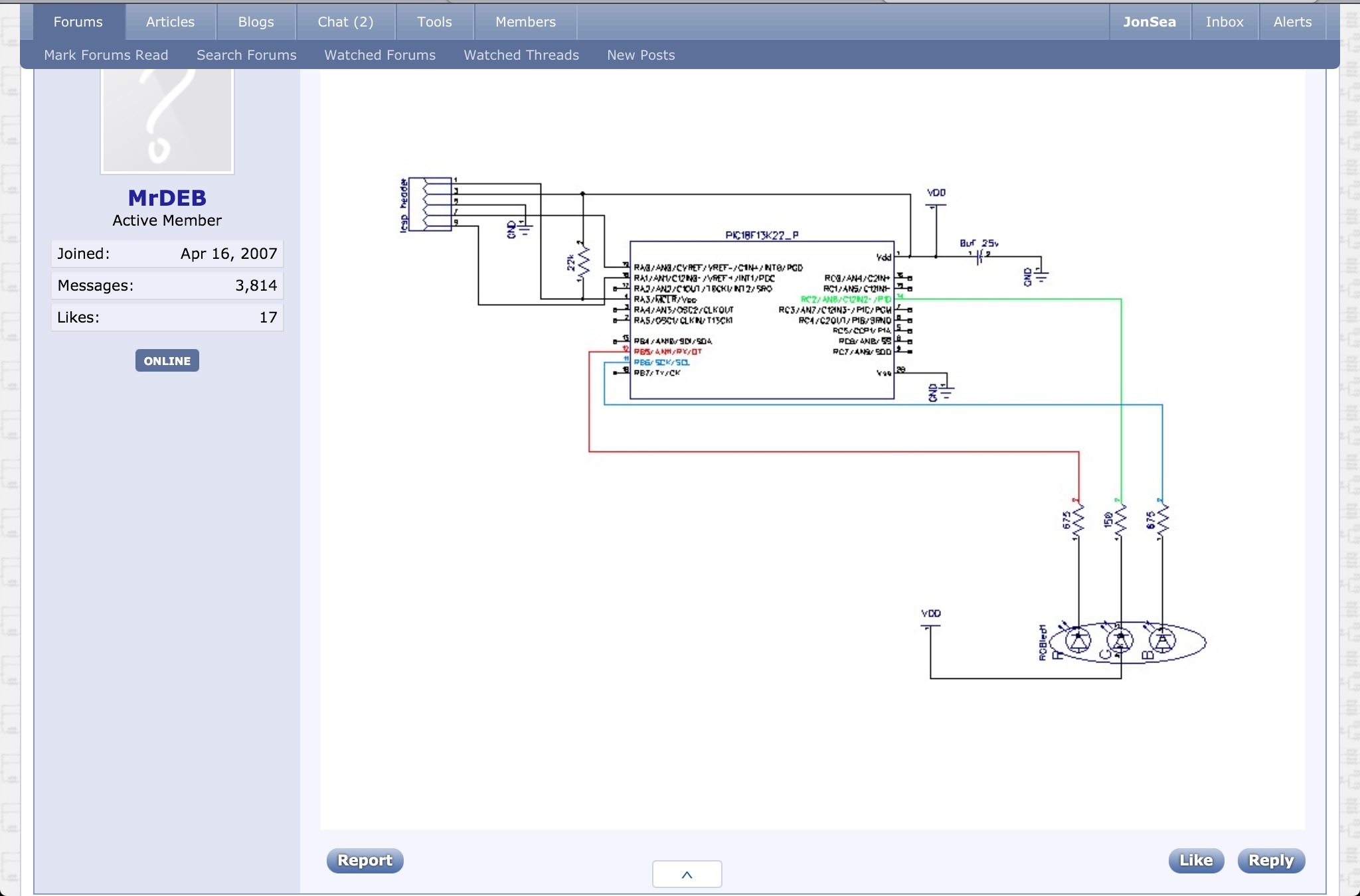

MrDEB, you might read my post #139 to understand why people are responding more and more negatively to you. When you fail to acknowledge the effort people are making on your behalf they become annoyed. Yes, people expect YOU to take a few moments to read, understand and remark on a post that may have taken 30 minutes or more to compose and proofread.
But, since you are focused on your schematics, may I ask if you actually look at them after you post them? If so, don't you notice the fact that there is not enough resolution to read the text? Below is one of your schematics. Notice the text is a blur.

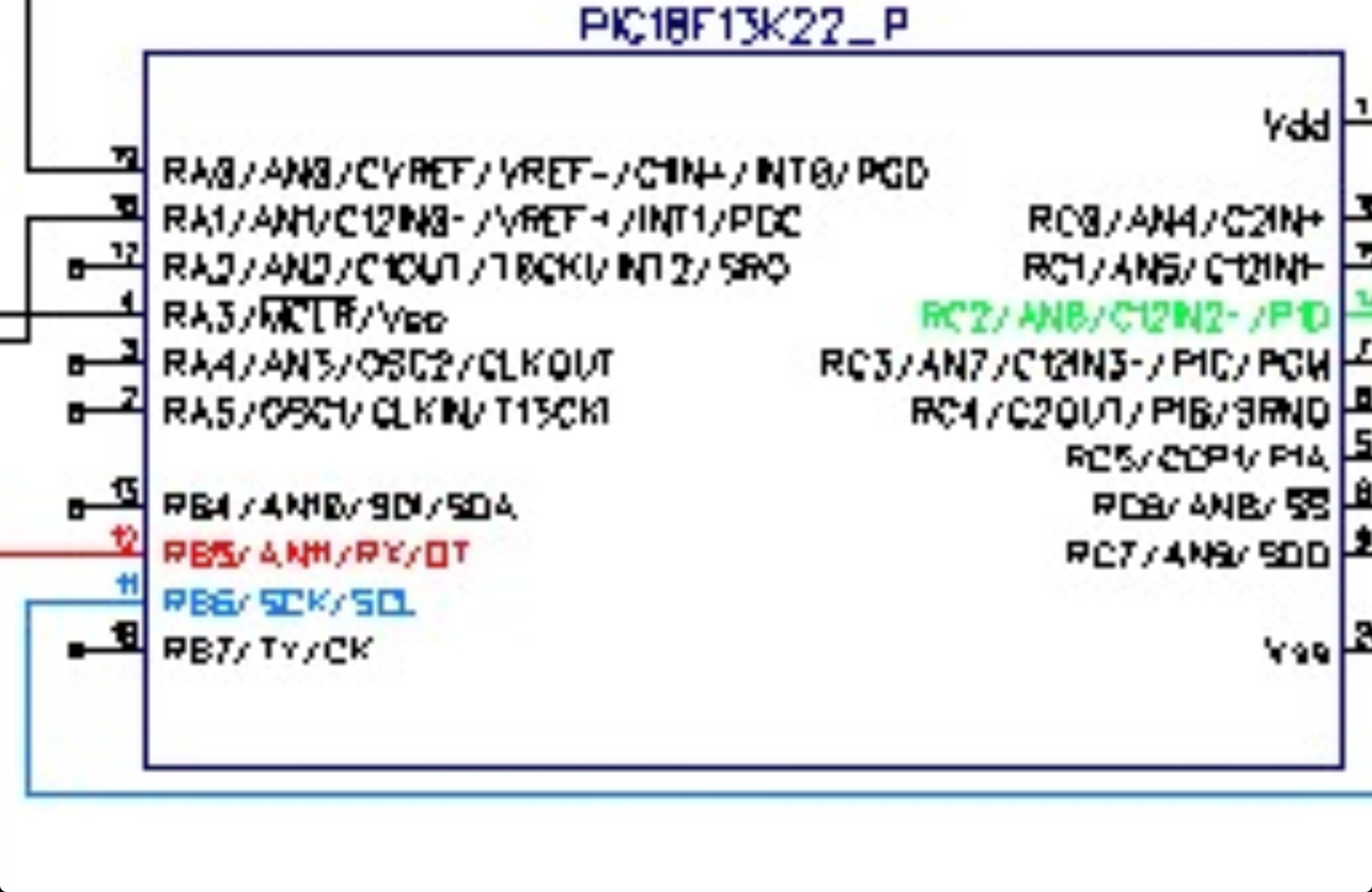

Below that is a zoomed section of the labels. They can't be made out because you didn't save the image with enough resolution. This has been discussed to death before and I'm not going to discuss it further here.
On the schematic posting I am going to change the type font Go from Vector to true type. I think this is what I did in the past but find no reference to it.

For your schematics, the issue is that you need to save them with more pixels – it's not a problem with the fonts. I know this was covered before because I installed DipsTrace just to test it out for you. Compare the jaggies on the curved lines in your schematic to one of my schematics here.
Regarding using a transistor vs separate port pins. I'm not trying to rain on your parade, but you have another issue to consider. Yes, a PIC18F-series port pin can source or sink 25 mA. But there's a limitation on how much the chip can source or sink. In addition to the 25 mA limit of a port pin, you have to consider the total current into or out of the PIC. This is listed in the Absolute Maximums section of the data sheet; "absolute maximum" means exactly that – exceed the values listed and the operation of the chip is no longer guaranteed.
I've lost track of your circuit configuration. I think you're sinking current (i.e., supplying V+ to the LED and providing a ground via the port pins), so you may be ok but you need to keep these limits in mind:

On posting the schematics I am pretty sure I increased the number of pixels but will post another later to see.

$1.80!!!!! i will go find a cheaper option :D thank you for looking at it jonsea. I confess i didn't see the multi led thing, just 5 channel. So it's going to be a bust :( i will search again! God this google is good,it took just over 4 min's to find that page.
Jon it can't cost much when you get samples for free lol. Your right it's not that costly I'm not being smart but when a 6 cent part is to much. How can it be to much what he wants is easy to do if you did it the right way. But I guess we don't know what where talking about.
Makes me wonder what I been doing for 30 years lol
Would it be worthwhile asking all this, on say the Swordfish Forum? You never know someone might have some code.
Or is there forum like Microchip's?
