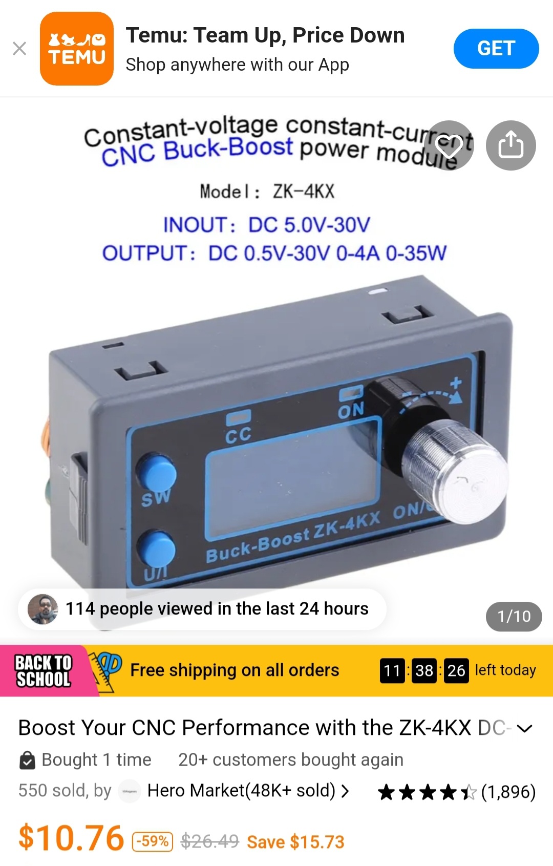

A bench power supply sure would be handy but have none so contemplating building one using a LTC3780 DC ADJUSTABLE CONVERTER. lots TO DO
Get one of these. Connect a 12 volt or 19.5 volt power supply brick and you'll have something that works.
