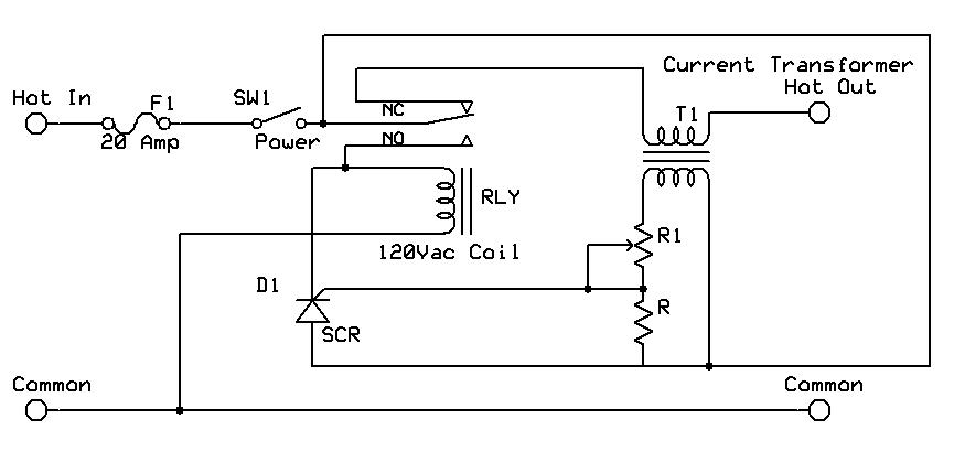

Would Something like this work?
Maybe instead of using a voltage divider make selectable taps on current transformer secondary. or maybe both for fine tuning?

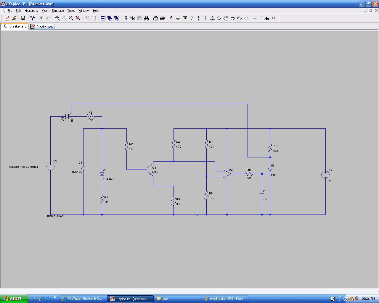

Here is the idea I had. The posted circuit needs some refinement, but I post it here so you know what might be involved. There are lots of different ways to do this, and I make no claim this solution does it with the fewest parts. Also, please note that U4 is a traic, and not an SCR. I used the SCR symbol because I still don't have a good triac model. I'm working on that.
In the diagram, R3 represents a load that will be plugged into the unit. A voltage that is proportional to the current drawn by the load appears across D1 and R1, which is amplifed and buffered by Q1. That signal is compared against a variable reference by U2, and when the current is higher than the preset value, U3 fires, which in turn inhibits U4 from passing current to the load.
The trip point is set by adjusting R7 and/or R9. The circuit is reset by cycling power. A switch can momentarily disconnect V2 to reset the circuit. Also, V2 can be generated directly from the line voltage, since it's not isolated.
This circuit, if built, is of course very dangerous, and will need to be housed in a totally electrically insulated enclosure.
I'm working on getting a triac model and refining the circuit to achieve the required amperage range. This is just a concept at this point. Suggestions are welcome.
EDIT: One weakness of this simple solution is that the negavtive half cycles aren't being monitored, and so the device bring protected might experience the full force of the negative half cycle of power before the circuit kicks in. This can be easily solved with the addition of a few more parts.
