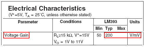

mstechca said:
audioguru said:
A comparator won't pass audio, its output is a square wave. :roll:
You sure an analog one wont?
If I take a common LM393 analog comparator and feed it maybe only 100mV or more of audio, I am certain that its gain of 200,000 will cause its output to be a square wave. Try it before suggesting it. :roll:
An analog comparator is a switch. Its output switches either high or low to indicate that one input has a higher or lesser voltage than the other. :lol:
