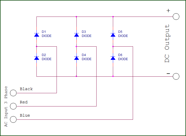

Assuming you be driving the transformer with the correct 3 phase power rectifying the output to DC will not be difficult. You only need a 3 phase rectifier or 6 individual diodes that will handle the voltage and current.
Using discreet diodes it would be configured like the attached. Ignore the colors I used at the inputs as the drawing was left over from something else. Also the drawing does not include a filter capacitor which may be needed.

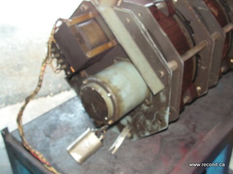

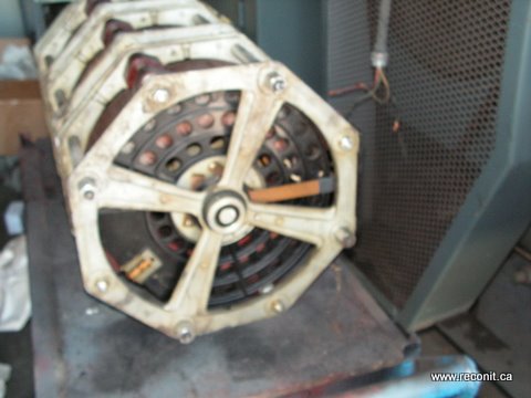

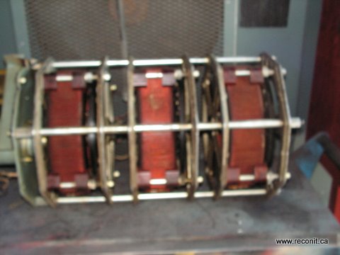

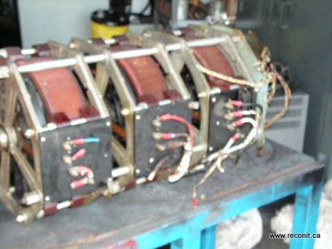

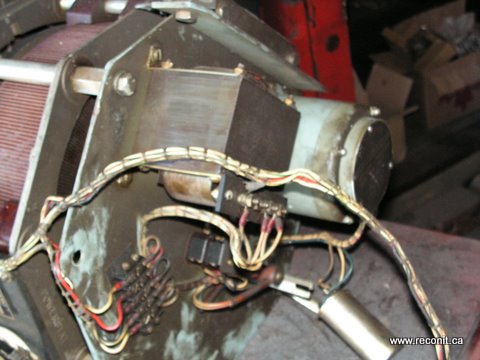

Hi Ron
Here are some pictures of the transformer. I will check with the guy who sold it to me.

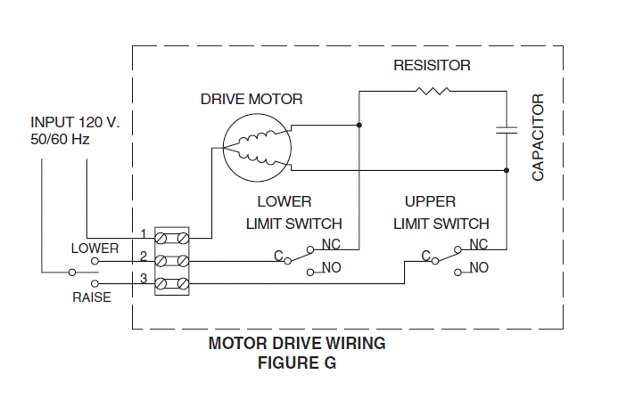

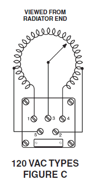

Thanks for the pictures. Yes, you have a 3 phase variac. Pretty typical. I also see the capacitor hanging out there for the motor reversing circuit as well as at least one micro-switch (limit travel switch). They are large and they are heavy. :) I have several really large ones at work. If you go back in this thread I gave a link based on the original post. Your pin out (the connections) are the same as one example in the link. Let me attach a few images.
Now in your pictures I also see a small power transformer, I'll venture a guess that provides the power for the motor. This is interesting as the manufacturer said it was a 120 volt variac but if that were the case there would be no need to use a transformer for the motor drive.
We are going to need to know what power you have available as to 3 Phase. Voltage and configuration.
Ron

I did receive the following message from Powestat.
My apolagies. The ratings I gave you were the ratings for each deck. That was how it was used in the unit it was stripped from.
If connected with all terminals #1 connected together and to neutral, while terminals #4 are the hot of A, B and C phase, the unit can be used for an input of 208Y/120 (208 line-line & 120 line-neutral) or 240Y/138. The max output will match the input and be rated for 45 amps.
The transformer must be the auto transformer which stepped the input line-line voltage down to the motor voltage of 120 volts.
OK, no problem and all you need is 3 phase power. Got that? They ran 3 phase Y (WYE) configuration. What he told you makes enough sense.
