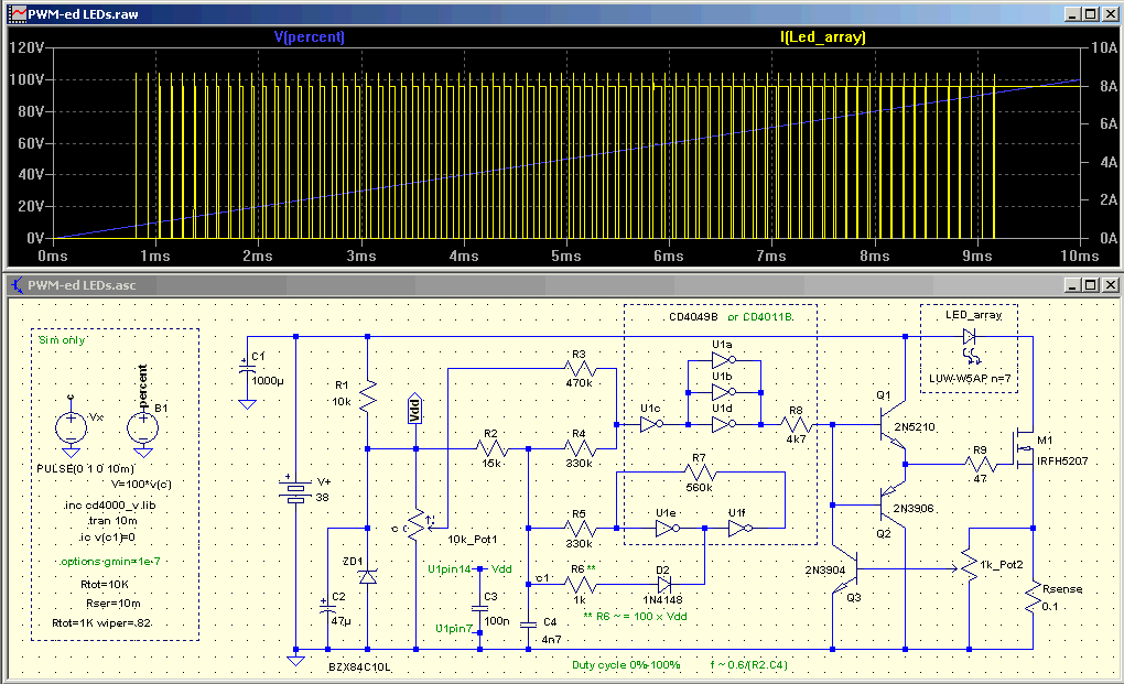

Here's my suggesion for a PWM-ed system with current limiting.
Pot1 sets the PWM duty cycle and hence perceived LED brightness. Pot2 sets the current limit.
The PWM generator operation is described in my Article.
The current is the problem I need to reduce the current will the 0.2 ohm 15 w resistor in series be enough to drop the current 2 amps as I keep destroying the led lightes.

Doesn't quite answer my questions but lets work with what you've given. And you've already got a PWM controller for brightness as well, I presume you're already using this Si14HyATPC1-50V-20A for dimming?
Anyway, I'm just gonna assume that if you apply 30-36V to the LED's that it'll work fine and the LED's can handle that kind of current. Adding to this, lets assume at 36V its gonna pull 9A because thats how you've specced it.
Further to that, lets say max input voltage would be 37+2=39V. That means you need to drop 3V somehow before you hit 9A. 3V at 9A gives you a series resistor of 0.33Ω. So if you slap in a 0.5Ω resistor in there you should be fine. One component, job done. Only thing to worry about is the power rating of that resistor. As a worst case lets assume the full 9A will be flowing, which it wont because the resistor is 0.5Ω, not 0.3Ω. Either way, 9*9*0.5=40W potentially. Can get those off the shelf for less than a few dollars.

Your operating conditions vary to widely to be able to do adequate current control with pure resistance. Your battery voltage will be as high as 42 on peak charge (unless you never run the LEDs while charging) down to 30Volts at the low end of the charge cycle. As such, the voltage dropped across your resistor varies from zeroV to 6V. With a half ohm resistor, your current will range from zero to 12 Amps. And it won't max out at 40 Watts. Even if the LED forward voltage stayed at 36, you could have as much as 72 watts. But led voltages decline with temperature. I don't know the exact ratio for your LEDs, but let's suppose 2V. You now have a 8 volts across your half ohm resistor giving 16 amps of LED current and dissipating 128 watts in the resistor.
If you had a higher input voltage you could get away with a linear control circuit, or a buck only switcher. But with the varying voltage that you have, about the only practical choice you have is a buck/boost switcher that provides some intelligent control to compensate for the operating variables.

I thought Gregory said his max input voltage was 39V. Either way, I explained all the steps and results with regards to HIS specs and he could easily go through it again with a higher max input voltage.
At 42V, he'll needs 0.66Ω @ 50W max. He could put in two 390mΩ 50W's in series. Still only a few dollars solution instead of having to design a whole 9A variable buck boost.
Unless Gregory uses two batteries as he implied, and his vin is then about 70V or so, and then Gregory can use a hysteretic buck. EG the HV9861A or the HV9910B say.

I have red all the posts and would like to know the general concenious of every one . I need to know what way to go to fix the problem of high current and voltage and make the current start at 6 Amps and adjustable and the votage at 36 volts Dc with what I have in place know or replace the unit with another controller. I thank you for your time and help but I need to resolve this
In the post that Flyback posted. Should I use this circuit in conjunction with the PWM.

Gregory, please forgive me but the fact that you are asking this question tells me that you are not very knowledgaeable about switch mode led drivers...however, due to your low vin and high vout, you will need a switch mode led driver...since I believe you don't have a good understanding of switchers, I believe you must get a higher vin and use a hysteretic buck type of buck converter, with the controllers that I have mentioned earlier...you will need your vin to be 50v at least, so you will need 16 lithiums in series, since they drop to around 3v at the end of the discharge cycle.
I looked at your controller datasheet, sorry I don't recognise what its supposed to be doing, it doesn't look like a controller that you would use to drive leds with...wasn't it a motor controller?
