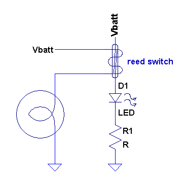

Anyhow, I've been thinking of creating an indicator panel for my truck. What I want the panel to indicate is the status of the lights on the truck, that way, the driver knows when certain lights have burnt out, or aren't functioning.
Here is the basic concept:
The panel will have an LED for each truck light, organized on the panel to correspond with the layout of the lights. For example, the headlight LED indicators will be at the top of the panel, tail light LED indicators will be located at the bottom of the panel...so on, and so forth. The LED will illuminate when the light is on, and stop illuminating when the light is off.
I don't have the specifics on the supply voltages / current for each light yet.
This seems so simple, and I'm a little embarrased to say, but I just can't seem to think of a simple way of turning an LED off, once a light bulb has burned out. (Again, I'm a bit rusty). :oops:

See the circuit that John1 posted at the bottom of . I love it.
I've posted the mods you would need below. You will have to experiment with (or calculate) the number of turns required to keep the reed switch closed. Unless you buy the switches surplus, I believe you will find the pull-in/dropout spec'ed in ampere-turns, so if you know how much current your bulb draws, just use a number like twice the pull-in. So, if your bulb draws 5 amps, and the pull-in is 15 ampere-turns, wind 6 turns of wire around the reed switch (giving you 30 ampere-turns).
Obviously, both circuits are series circuits, so you can arrange the parts in any series order that is convenient.
