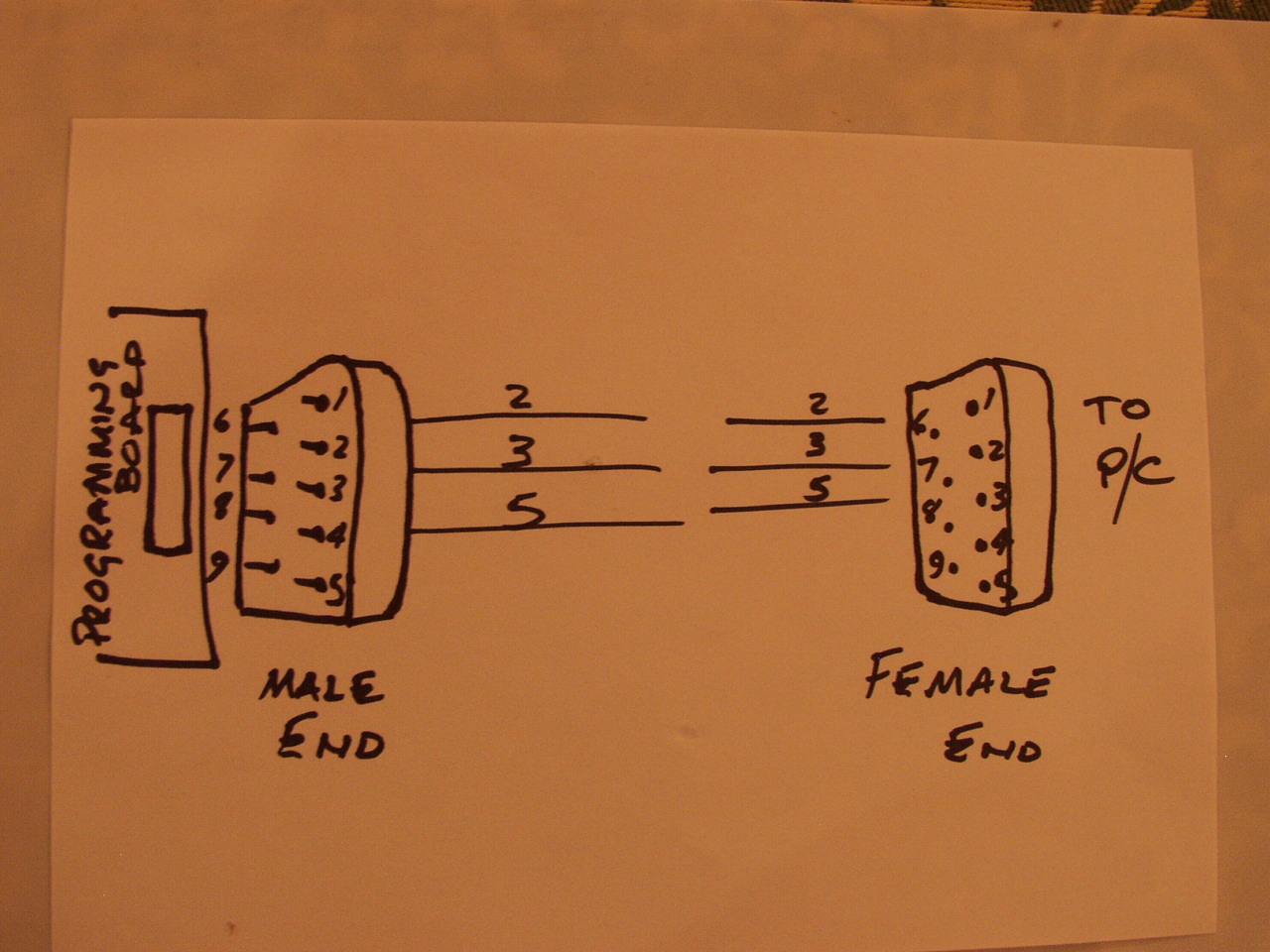

This is my first attempt at PIC programming. I have the 8048 programmer.
When I try to "write", I get the message " K8048 not found at COM 1".
I already have Picaxe programme editor installed on my PC, and I am wondering if there is a conflict, but I do not know how to configure COM 1.
Also, I could not find a serial cable to use with the 8048 programmer, so I made up a temporary one, connecting pins 2,3 and 5 "straight" not crossed in any way.
Has anyone any idea as to why things are not working?
David Miles.

Your cable has to be wired 9pin to 9pin straight through plug to skt going from what I see on the schematic...it is not actually using an rs232 protocol, rather, it's using the com port to control the various switching transistors etc

For a start you need a correctly wired lead, it might then work OK? - it certainly won't at the moment, as you don't have it connected at all.
OK.
Here is a picture of my "made up" cable.( I hope it comes through ) Can you say if it looks OK?
David Miles.
You've not been reading the previous posts! - it's NOT a serial port programmer, it's a programmer that connects to the handshake lines of the serial port. Out of the three pins you've wired only ONE of them is used, and that's the ground connection.
If you don't want to wire all 9 pins, check the circuit for the programmer and see which ones are used - it's got to be more than three, there's at least Gnd, Data, Clock and MCLR - and possibly Vcc as well.
I don't really understand what you said about serial ports and handshaking, but never mind, I will wire up all the pins ( straight through ) and see if that changes anything.
David Miles
As I said before, just look at the circuit diagram, this clearly shows the only pins connected are, 3, 4, 5, 7, 8, and 9 - there's even a wiring diagram for the lead in the assembly instructions!. BTW, pin 3 (and pin 9) are only used to provide a negative bias voltage for the RS232 level converter on the programmer, and to switch between programming and normal modes.

I have made up a cable using all 9 pins and it works fine. Thanks for pointing me in the right direction. I would like to say that, apart from the fact that I don't have the assembly instructions or the circuit diagram, I do not find this whole area of electronics very easy to get to grips with. I am at a real entry level, but I am trying!
