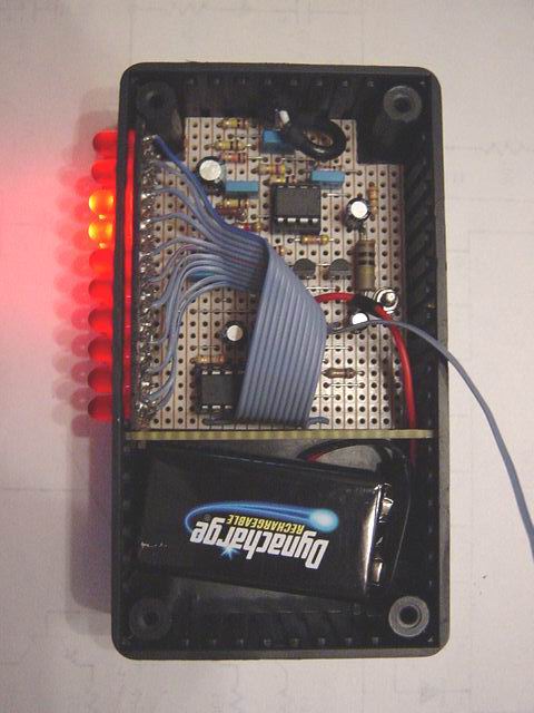

I designed thousands of circuits on Veroboard during my career. Most were made by my colleague, a craftsman. Some were extremely big and complicated. Most of my veroboard circuits were made only one time and they looked good enough to be sold. None ever failed.
Hi Sarma,
I will be 67 in less than three weeks. My eyes are still perfect because their lenses are only 4 years old (cataracts surgery).
