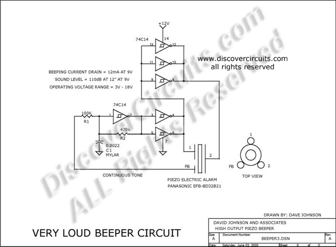

Hello, I hope everyone is well.
I created a bicycle horn from a CO detector simply because the buzzer is
extremely loud and can be heard from a long distance.
When I use the (modified) CO detector board the buzzer is very loud.
I created my own circuit from a schematic I found on the net,
however the buzzer is not as loud as it was on the original board.
I have included my circuit below.
Any advice as to how I can increase the volume on the buzzer?
For the R1 resistor, I used 1M instead of 1.5M because that is all I had here.
Any advice is greatly appreciated.

In your circuit, R1 is there to prevent the IC1B input stage protection diodes from messing up the oscillator waveform. As long as its value is 10x R2, just about anything will work.
If the sounder is a 3-terminal piezo element, then the original circuit might be driving it at its self-resonant frequency. This is the way to get the max possible volume despite minor variations in the elements due to production tolerances.
Another possibility is that the 4049 cannot source or sink very much current, maybe much less than the original circuit components.

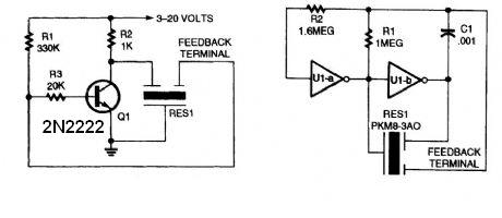

Here are two variations. One is a CMOS circuit with paralleled inverters to increase drive current, and one is a 1-transistor version. Note that the transistor can move a lot more current than a single inverter output stage.
ak
Wire up the other 4 inverters in your original circuit in parallel with IC1A.

Nope. That is what R1 prevents. It also prevents soft-clipping of the capacitor voltage waveform, which would increase the oscillator frequency above the calculated value.

What is a CO2 detector? We breath out CO2 and soda pop has CO2 in it, it is not dangerous.. Maybe it is a CO detector because CO is poisonous.
A CO detector circuit uses a transducer is a piezo that is loudest at 3kHz to 5kHz. Its frequency is much higher than then 455Hz of your CD4049 circuit.
I agree that its piezo uses 3 wires (one wire is for feedback) so that it operates at its loudest frequency.

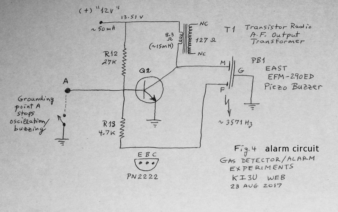

Often an inductor is used to increase the drive voltage (and hence volume). Your photo of the PCB seems to show a blue inductor in the top right corner?
Here's a driver circuit for your transducer, incorporating a tapped inductor (unknown tapping point): http://www.east-elec.com/sounder/efm-290edfp
Another driver, this time with an untapped inductor: http://ki3u.byethost3.com/Instruments_etc/Exp_Gas_Detector/Exp_gas-detector-alarm.html

I created a schematic of the actual buzzer circuit on the CO board. I triple checked it.
I am hoping it is correct. If something is obviously wrong please let me know.
I am not very experienced with eagle.
I didn't find a 3 pin inductor so i just used a 3 pin header and labeled the pins, same with the buzzer.
I also don't know what part number the inductor is,
as there are no markings on the component except for one red dot.
(you can see the component I am referring to in post # 7, the blue component in the picture)
Hopefully someone will know what the value is so I can order a few of them.
Most of those parts just make up a switch. The oscillator part only uses a single transistor. Here it is without the unneeded parts:
The circuit is similar to the two I posted, above. You can make your own 3-legged inductor by winding a bunch of turns around a 2-legged inductor (you want 10mH or above). Alternately, just use the circuit that doesn't need the 3-legged inductor.

With a 9V supply, the 4049 circuit can drive the piezo with 9V one direction, and 9V in the other; this is 18V peak-to-peak (maximum; limited by 4049 output current). The circuit with an inductor will drive it 9V in one direction, and spikes of perhaps up to 50V (wild guess), in the other direction. You'd expect this to make it louder.
