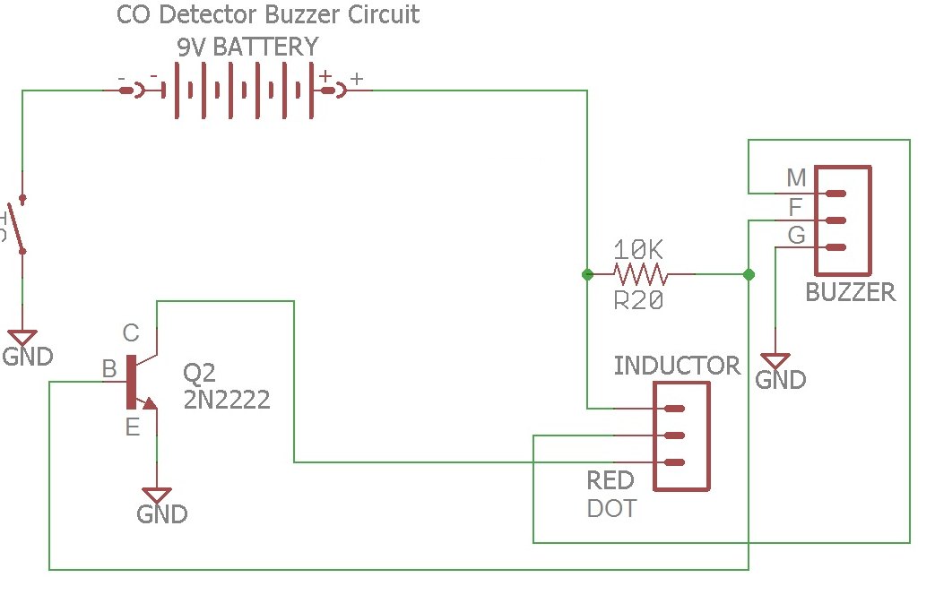

I created a schematic of the actual buzzer circuit on the CO board. I triple checked it.
I don't think it is entirely correct. However, it is so similar to the first one in post #11 that they are functionally identical. The tapped inductor is acting as an autotransformer. The original circuit is louder because Q2 can sink a lot more current than 3 B-series CMOS gates in parallel, and the inductor boosts this to a peak signal voltage that is greater than 9 V at the element.

With a 9V supply, the 4049 circuit can drive the piezo with 9V one direction, and 9V in the other; this is 18V peak-to-peak (maximum; limited by 4049 output current). The circuit with an inductor will drive it 9V in one direction, and spikes of perhaps up to 50V (wild guess), in the other direction. You'd expect this to make it louder.

The tapped inductor in the original alarm circuit almost certainly is a custom part.
