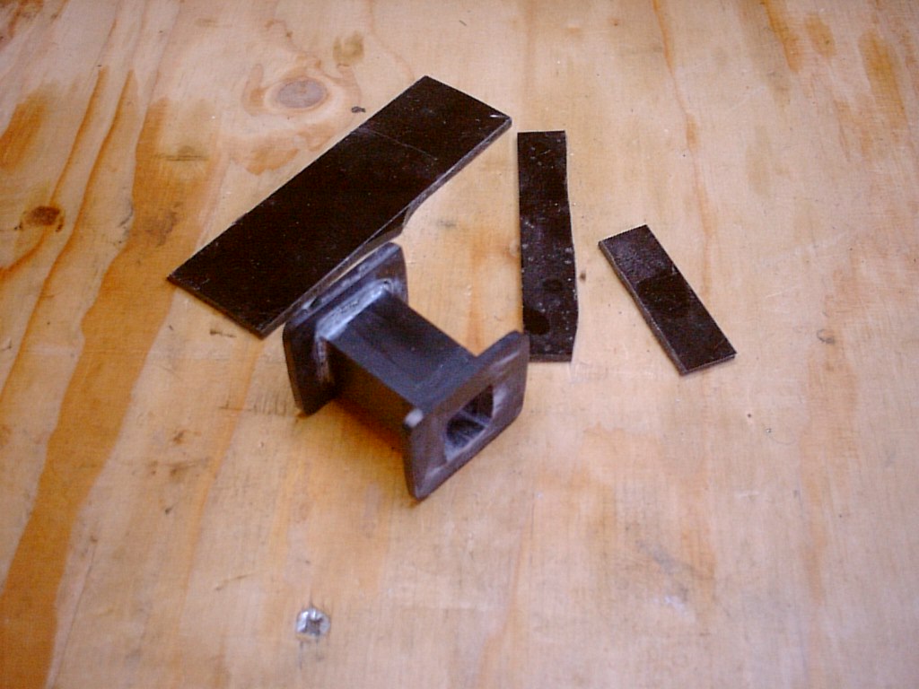

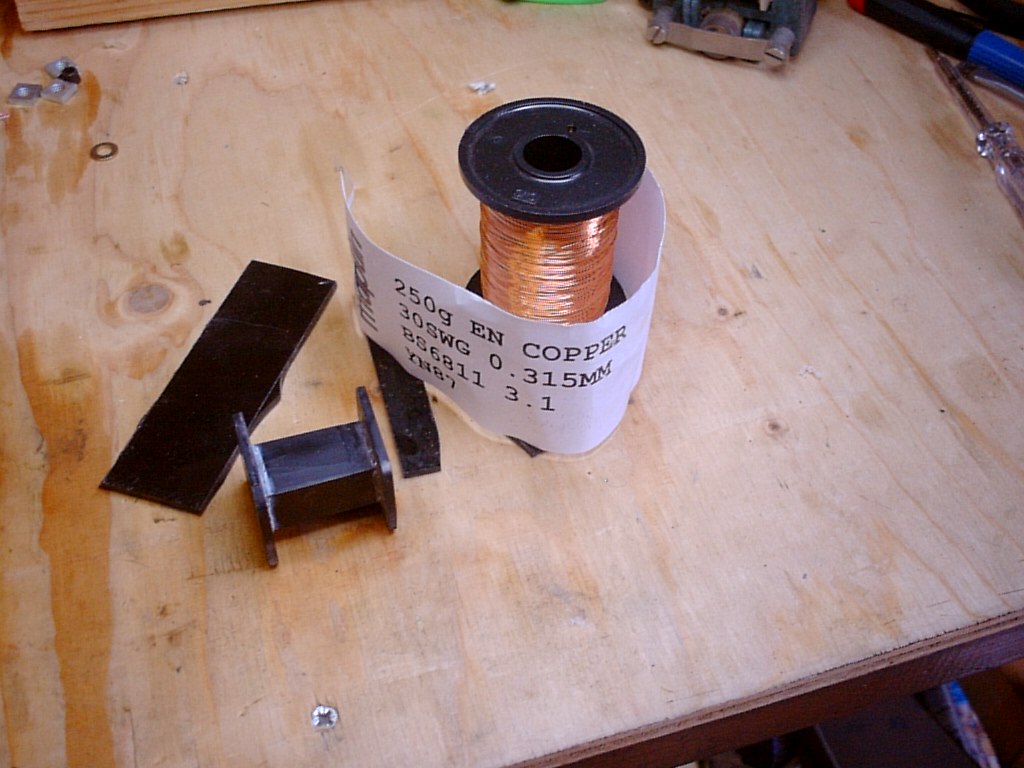

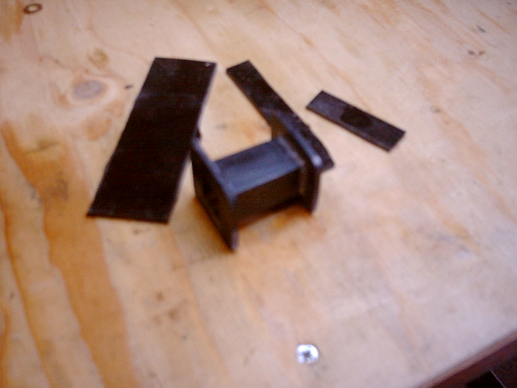

hi Mark,
Have you actually dismantled the metal core on which the former fits.??
So that you can slide on the new coil.
You can make a former from thin plastic sheet, use an old solder tip in your soldering iron to heat weld it.
Ready for coil winding.
Hi All
I have now made the former for the new coil.I ended up using 3mm plastic as I had it to hand and Super glue.I now also have the SWG.30 and so I'm now ready to wind.
I have a lathe with very good speed control and could use this and do by hand.
Trying to do a visual count to 800 or 1000 turns will send me wappy and I will probably go mad before I get to the end.:eek:
Being in to electric clock I'm sure I will have more coils to wind in the future so I think it might be best for me to make my own dedicated coil winder.
Think I will start a new thread on that to seek advice.
