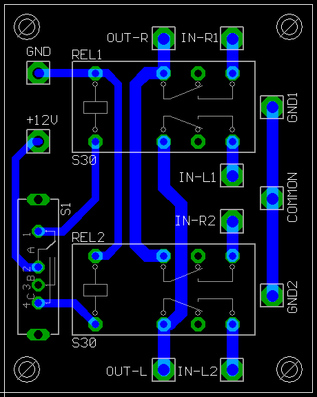

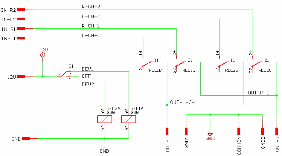

If your audio devices deliver car hifi at high power it's advisable to use relays and activate those with a switch, which only should toggle ON - OFF - ON, activating either relay.Don't forget to connect device grounds. If they are equipped with bridge amplifiers ground is not required.To make that sure better ask audioguru.This what the switching device could look like:Boncuk
