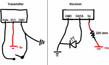

I bought this transmitter module and receiver module online and made a very simple circuit.
I think the problem is the output is TTL (transistor transistor logic), which I kinda understand. But I'm having trouble.
I should be able to press the button and have the led light up.
I included the circuit and all of the information I have on each module.
RM1SH = Receiver Module
TM1000 = Transmitter Module
The only additional information I can provide is photos of my setup. But I supplied my circuit and reference information, so I doubt it'll help you. But if you think it would, I'll be sure to include pictures. I really want this to work. Learning about wireless data transmission is hard!

Why do you put the resistor to the supply of the receiver?
RF module is AC coupled, isn't it? It can't send a long high or a long low signal.
See these:
I have a resistor because it needs 5 volts and my supply is 6. My resistor should drop it down to 5, right? Technically it can use 3-6, but they recommended 5. Or do resistors or limit current? Anyways, it doesn't work with or without the resistor.
I'm not sure if its AC coupled or not. We have the same amount of information, just those two PDF documents. How do I know if its AC coupled?

Kind of...it will only drop enough if the device drawing enough current. THat also means the supply voltage changes depending depending on the current draw of the device. A voltage flucating wildly within the operating range and a stable operating voltage are not the same thing. Use a regulator.
Yea, I actually happen to have a 5v regulator on my desk, not that it should matter. I don't need something permanent or stable. Just a proof of concept that I can build on later.
I tested my RF module by injecting 10 kHz squarewave into the transmitter data pin, then I see the receiver data pin from the oscilloscope, to check whether it is working or not.
I've tried also put a switch to the data pin of the transmitter, and a LED at the receiver; but the LED won't be turn on or off when I turned the switch on or off, the LED was just floating. So my RF module is AC coupled.

Is the output high from the receiver only a few uA of current (TTL high)? Then it won't light an LED.
Is the output low from the receiver 16mA like TTL?
Then if it goes low long enough it will light a current-limited LED. If you don't use a current-limiting resistor for the LED then the receiver, the LED or both will blow up.

You have to send a signal that will pass through AC coupling, my PIC tutorials have details of how to do it using PIC's.
I messed with the receiver circuit. Nothing was being transmitter and the led lit up. What does this mean? That the Data and Gnd terminals are linked?
The output is TTL. So when I do receive data, the Data and Vcc terminals will be linked?

Like I said above, check my PIC tutorials for examples of how it's done, or use Holtek encoder/decoder chips (which are just pre-programmed micro-controllers).

Hi, I've some good news for u :) . I'm working with that module for some months, and I have had no problem, except of course, that I can't make it work 1Km as the data sheet sais. I just make it work 100m. But that's another history.
Look, as bananasiong said , the module does not suport high(5V) for much time, it's just a matter of miliseconds and the output in the receiver fall(0V). So, u never gonna see the led turning on or off.
What I recomend is that you try with a microcontroler sending serial data. U will see the data going from the TX to the RX. The TX speed is up to 9600bps. I know it sounds a bit complicated, but is the only way u will see them working.
The other, of course is trying with an osciloscope and a generator.

Ah, sth I forgot. the resistense has no sense there. You should join directly to VCC, but i recomend that you use 5V
