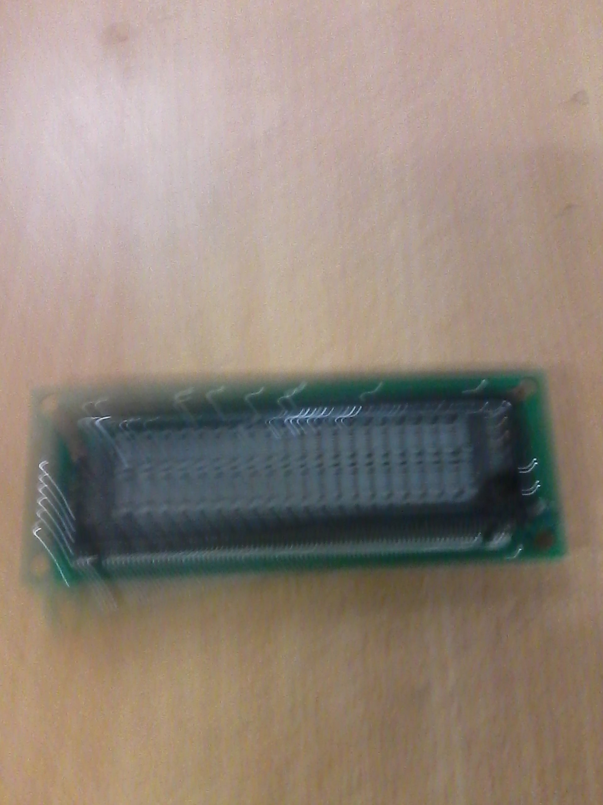

I pulled this from a dead piece of kit, I like the Vfd panel, I've driven these directly before but this is the first module I've had.
I expected it to have the usual 4/8 bit interface as found on a 2x16 lcd module, however this one is different, it has a 5 pin connector.
Would this be a I2C interface, or some weird protocol, the module is made by futaba.
I have driven a few modules like this, and most of the ones that I have seen with a serial interface use a standard 3-wire serial inteface (Data, Clock, Latch). You will probably need to look up the part number of the module or the controller on the board to determine the pinout.

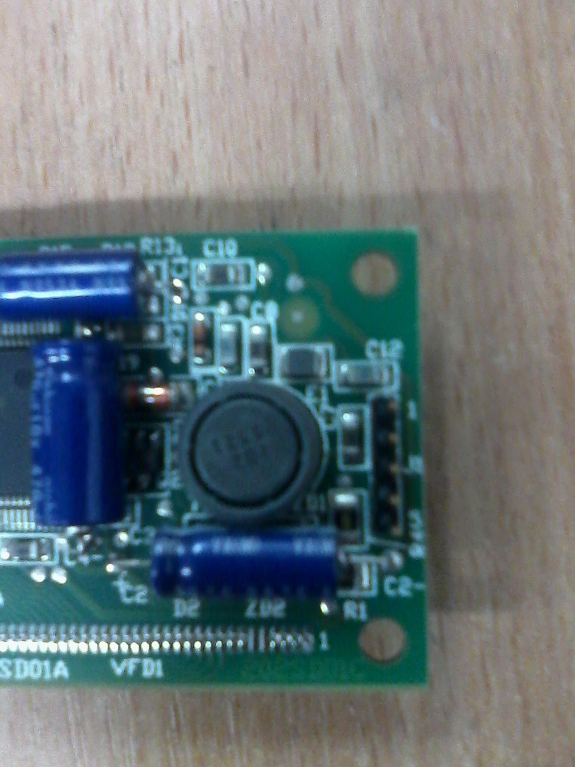

The module looks to have a voltage converter on board, so it can probably be driven from +5V without a separate supply for the VFD plate voltage.

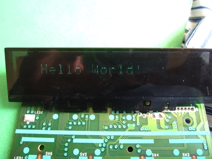

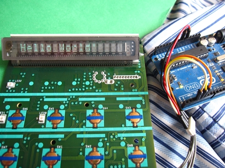

When I did this, I just bit-banged the data manually. This was all years ago, and I think I may have lost my original code some time ago, but I might still have a picture of my setup.
EDIT: I found the pictures! This was a random VFD display module that I scrapped out of an old printer. It had a small voltage converter on board, so I just fed it 5V power directly from my Arduino. As I said, I'm pretty sure I lost my code for this, but I'll check some of my backups to see if I can find it.

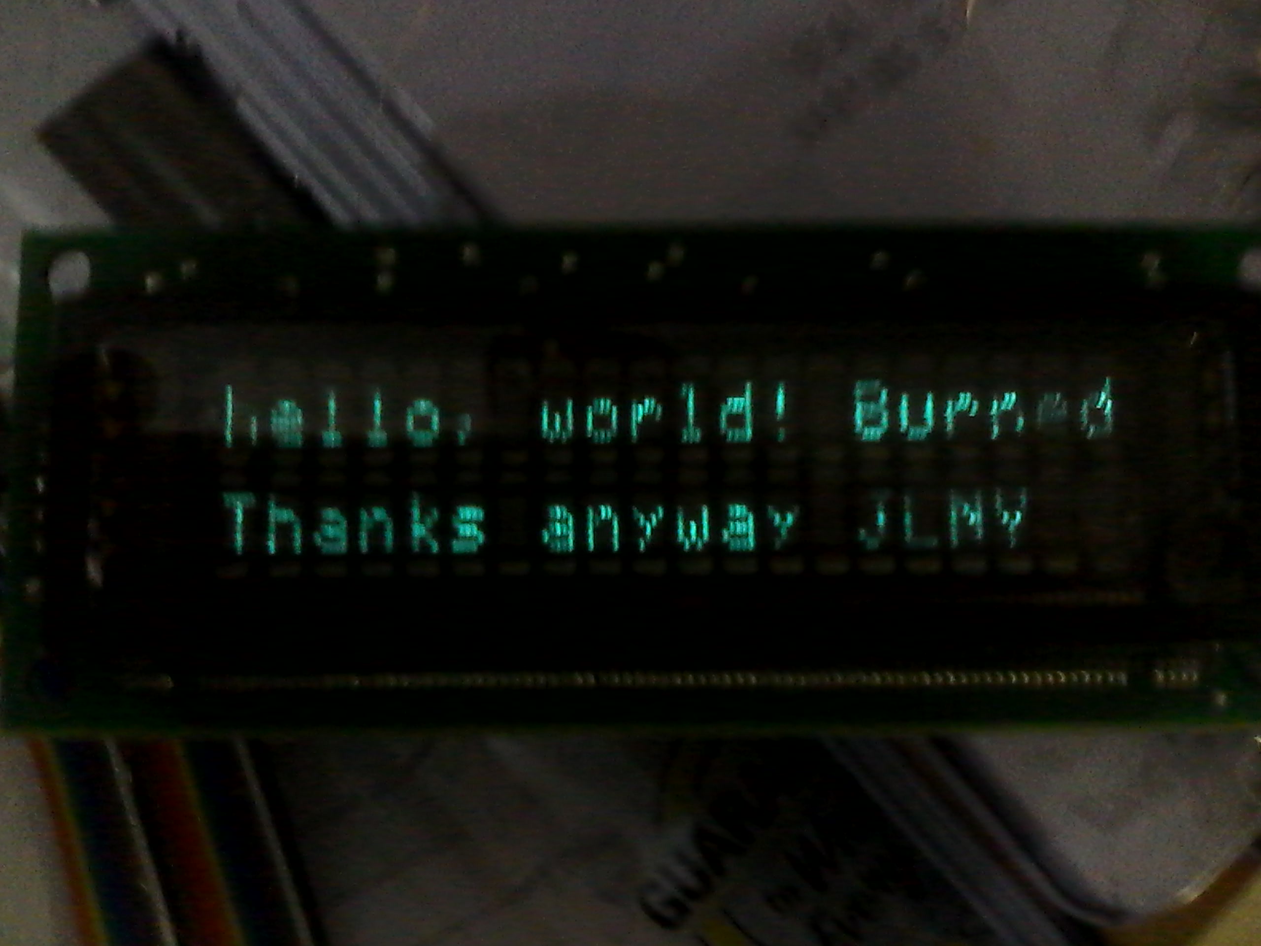

Well I got it to work with the above, despite my efforts I couldnt get the pic onto my pc, but its n=bad, really bad, I htink this thing must have been left years switched on, even with the lights off its hard to read.
I'll try the all segments on thing and see if that improves it any.

I have brought some life back to nixies by cycling them 0-9, so untill I try it I'm not going to bin it.
That said I cannot find the code for a solid block, the ascii code for it doesnt work, this module doesnt seem to understand extended ascii.
In the time I've had it switched on just cycling through characters it has improved, its spent most of its time showing the same text.
Reading through the datasheet for the M66004, the hex code it uses for a solid block is 0x7F, but I suspect different control chips will use different character tables, so you may just have to cycle through each character until you find one that works. Some controllers also allow you to program your own custom characters.
I once used one that had been on the front of a server, and had nothing but "OK" printed to it for probably 8-10 years non-stop. I was able to get it to a pretty usable state again by writing blocks to it, but the letters "OK" never fully went away.
