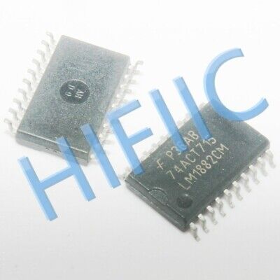

It can be done just with a chain of dividers and a few gates, or there are some LM1882CM / 74ACT715 sync gen ICs still about.
Such applications were common 20+ years ago, but most of the dedicated ICs for analog display timing have long since disappeared.
