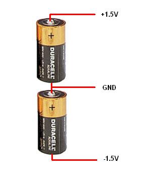

obrien.james said:
Im still not getting the difference between the -5v and the ground. Or are they the same thing???
James
-5v is not the same as ground. Below is an illustration of how positive and negative voltages are "created".
Ohh i get it now, i didn't realise that!! Thanks!!

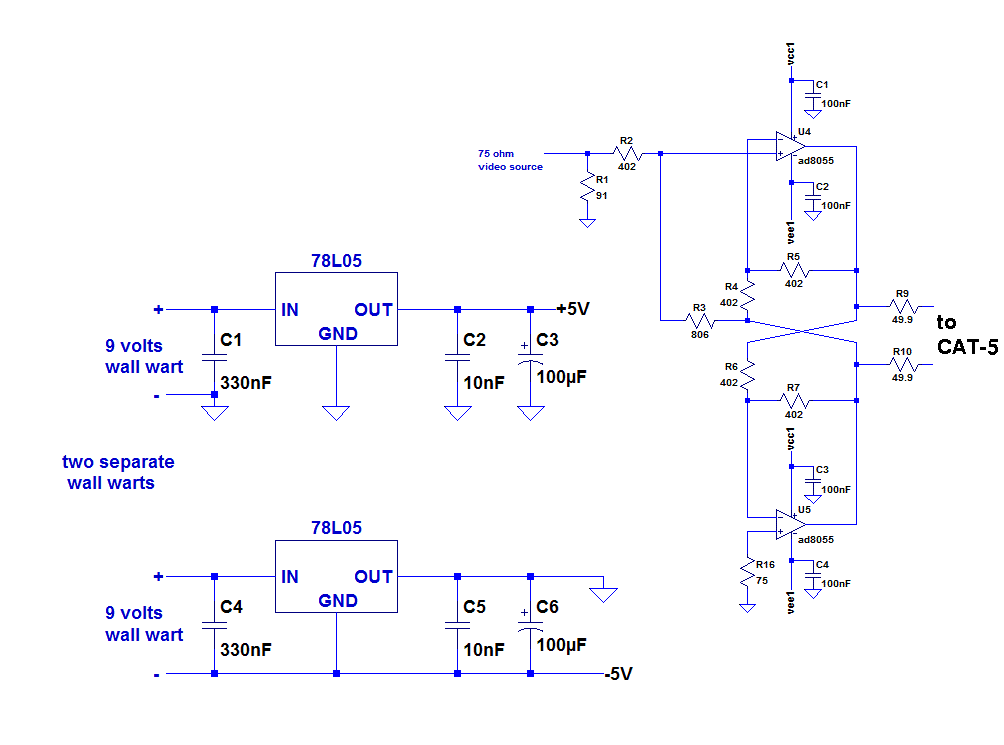

When making the power supply using a 'wall wart' how do i make the ground from that, is it just a row on the strip board that is connected to nothing or something else?? Usually the wall warts have -ve ----(o---- +ve so where is the ground in that ??

In your power supply, ground can be a row on your strip board.
Wall warts generally have an outer sleeve that is negative, and an inner terminal that is positive. I showed how to connect them in the power supply schematic. Note that, in the -5V supply, neither wall wart terminal is connected to ground.
There is generally nothing magic about ground. It is a plane or a strip (in this case) which is common to all the leads and terminals which have the little triangle symbols attached to them.

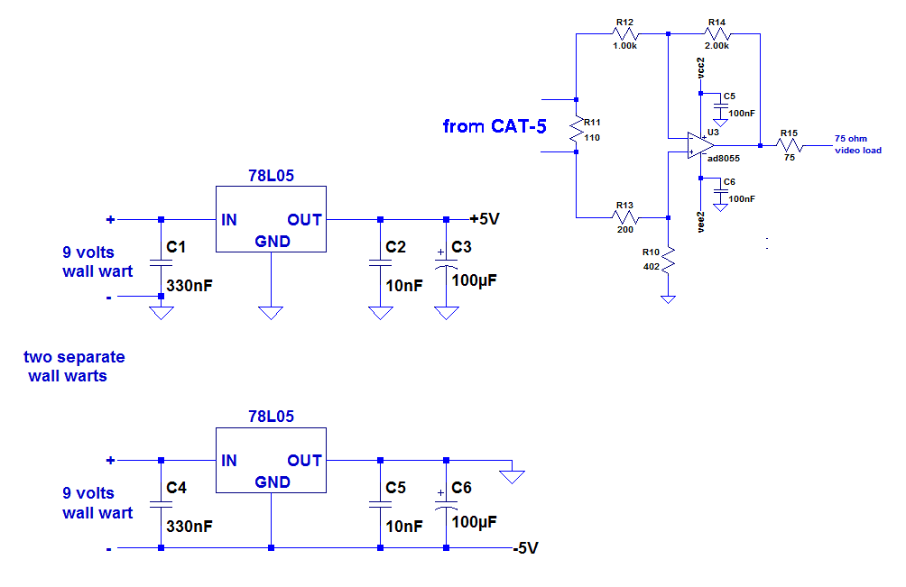

No, you don't. Looking at your most recent post, you definitely don't.
You need two separate power supplies for the transmitter (+5V and -5V), and two more for the receiver.
If ground was connected to nothing, it would not be on the schematic. All the points in the transmitter, and its power supplies, that have the ground symbol must be connected together. All the points in the receiver, and its power supplies, that have the ground symbol must be connected together. The grounds in the transmitter do not have to be connected to the grounds in the receiver. I probably should have drawn the transmitter and the receiver as two separate schematics, to avoid that implication.
You can use two unregulated wall warts for the transmitter, and two more for the receiver, but be aware that, under light loading, the voltage may be higher, so you have to pick op amps that will not be destroyed by the higher voltage.
This place and your guys are the greatest
james
Below are cobbled-up schematics showing the separate circuits with their own power supplies.
