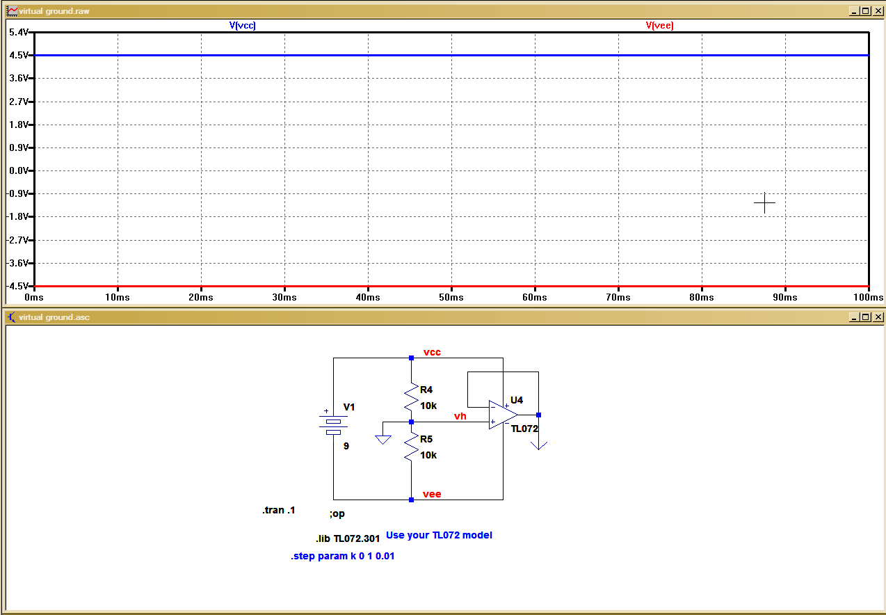

This sim works with other op amps I have tried (only 2 or 3 others), but TL072 gets it all wrong, at least using the model that I have.
Has anyone else seen this?

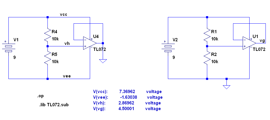

hi Ron,
My model suffix is .301 from YLTS.
I got exactly the same result values as you did.
The only work around I could find, is the 'COM' symbol on the 072 output.
Eric

Hi Eric,
SgtWookie on AAC found that TI had used GND (node 0) in their models. He changed them to the vee node, and all was well.
I believe SgtWookie also posts here, but under a different name.
Are you there, Wookie?
I've had the impression not, but if he does I would be interested in knowing.
