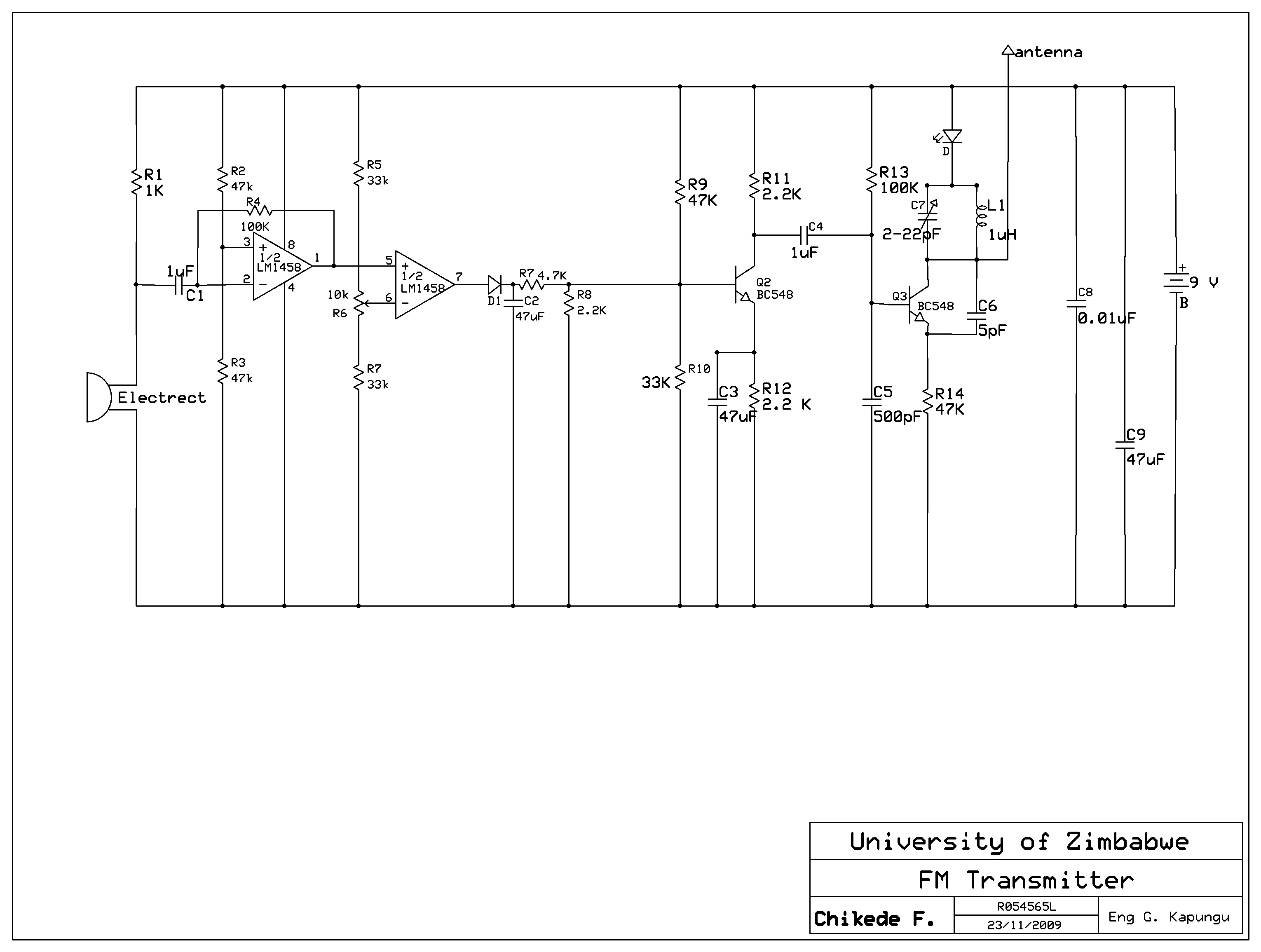

The aim of this project is to develop a miniaturized low power voice activated FM transmitter to be used in special applications such as room monitoring (in this case baby, patients or disabled persons listening device). it must transmit in the FM broadcast band.
Your circuit does make sense to me. The op amp stages will work ok to detect the voice and create a "transmit" function at the cathode of D1, but after that point it goes wrong. You then feed this transmit command into the modulation port of a simple audio FM transmitter. This is the wrong thing to do. The "transmit" function should be turning the transmitter on and off, not modulating it. I presume you want the audio to modulate the transmitter, but in order to do this, you need to feed amplified audio to it. To do this, I think you should make a connection through a coupling capacitor from the electret mic over to the junction of R9 and R10. You should also disconnect R7 and R8 from this junction. With these changes you have an FM transmitter that can be modulated from the mic, and you have an audio detector that isn't doing anything yet. Now, you need to attach a switch of some sort, perhaps a transistor switch, to the junction of R7 and R8 and put this switch in series with the power supply to the Q2 and Q3 stages.

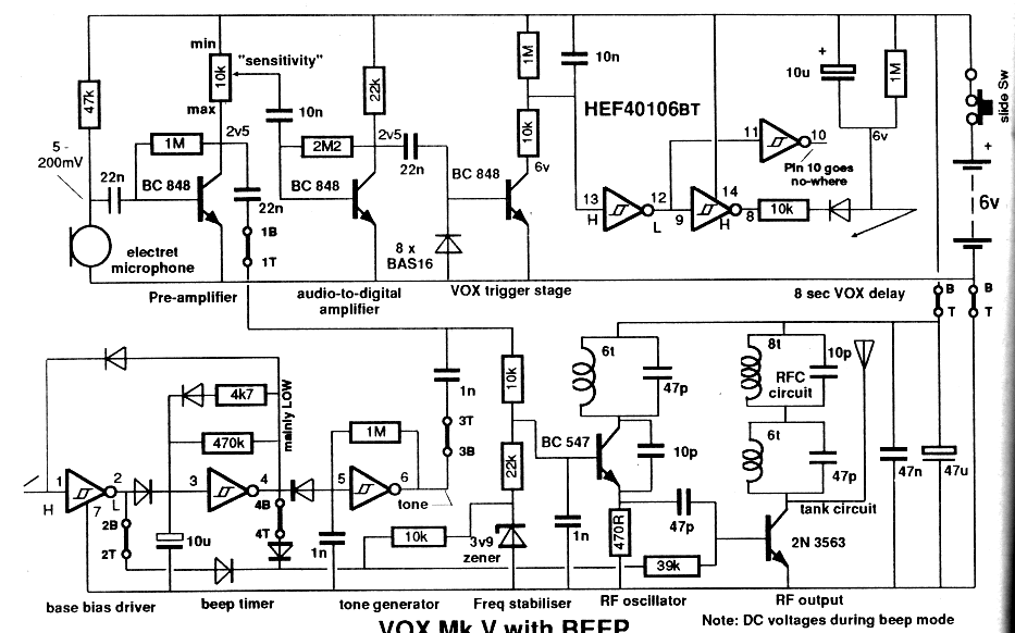

Here is a Voice Operated FM transmitter:

thanks l have done the modifications in the attached circuit and am looking simulation software for the circuit. other views are welcome
The radio transmitter part is not good:
1) Its antenna is connected directly to its tuned circuit so its frequency will change is something moves toward or away from the antenna.
2) Its frequency will change as its battery runs down.
3) The value of R14 is much too high and/or the value of R13 is much too low.
thanks so what are your recomended resistor values to the above., and how can l modify the circuit for it to perform better. which software can l use to simulate the circuit. on the battery how can l improve on the circuit for it to maintain constant frequency during transmiting throughout the battery lifespan.
R14 is usually 100 ohms to 470 ohms. R13 is usually 47k to 100k ohms.
If you add an RF amplifier transistor between the oscillator and the antenna then the frequency will not change if something moves toward or away from the antenna.
The circuit board must be suspended in a metal box connected to 0V.
Use a low-dropout 5V voltage regulator IC to power the oscillator and the preamp.
I use the free simulation software called LTspiceIV from Linear Technology.

The modifications are correct, you now have a topology that makes sense. I recommend that you follow Audioguru's recommendations on improving the transmitter section.
Your switch, Q1, is generally the right idea but not optimal. One problem that will occur is that the voltage divider of R7 and R8 will reduce the voltage presented to the base of Q1 to a very low value and so the emitter of Q1 will always be too low a voltage. You will need to improve the design of this switch. The most common successful configuration for a bipolar transistor switch like this is to use a PNP transistor (eg. 2N3906 or any other) with emitter as input and collector as output. Unfortunately, this PNP arrangement will require that your control signal be "active low" instead of active high as it is now. In other words, the base of the PNP switch must be pulled low through a resistor to turn the switch on, not high through a resistor as you have it now. However, you can easily reverse the polarity of your control signal by reversing the direction of D1. For the suggested configuration, you would also need to move R8, from its current location, to making a connection from +9V to the junction of D1 and C3. I suggest that R8 would become 100K ohms and R7 should become 18K ohms. C3 may be OK at 47 uF, but you may find this too small, perhaps 100uF would provide a longer "hang time" for the transmit function.
The clever part of my circuit is this:
It produces a beep when not transmitting so that you can detect the frequency on which it will transmit when turned on.
A VOX transmitter is much more complicated than you think and it took many hours to perfect the design above.
It's pointless re-inventing the wheel.
The circuit produced by the original poster has so many faults and mistakes that it will never work. He obviously has absolutley no idea what he is doing.
