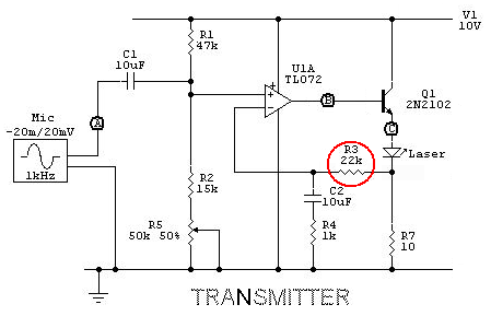

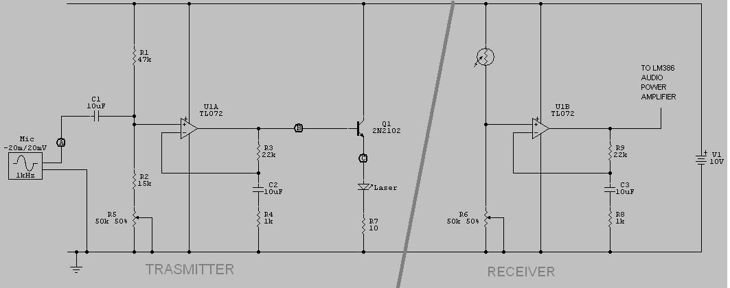

I want to send voice via Laser.
I also search on the net but i did not find any thing meaningful. I don't want to use transformer, all the circuits on the net have transformer used in it.
I am student i don't want to buy, i want to build.
This is my design in the pictures.
I want to ask experts that this circuit will work, if not then tell me what is wrong in it.

It's rather crude, but may work? - assuming the laser will accept AM modulation in such a fashion - and low audio quality is all you need?.
I would also suggest AC coupling the receiver opamp, no need for the LDR to be DC coupled
Of course the communication is AM along with all the reception problems with AM like interference. Using a high frequency carrier with FM modulation would be much better.
Of course the laser must shine on the photocell or it won't work.
Of course the circuit doesn't have automatic gain control like an AM radio so the sound will be very loud when it is close and very weak when it is far.

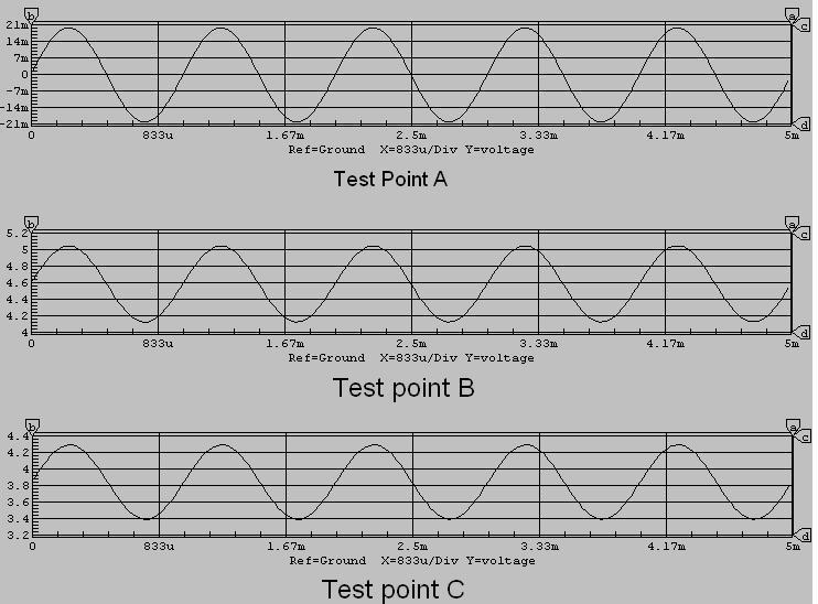

I modified your transmitter circuit to include the non-linearities of the transistor and the laser in the negative feedback loop of the opamp for distortion reduction.
