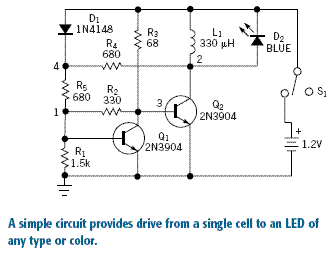

I found this: drive a LED with a single AA battery, is this also called voltage booster circuit? I've googled, some voltage booster use 555 timer, some use handmade coil with center tapping, and some use capacitor to hold the output voltage so that it won't be lower than supply voltage.
Can this circuit last long if i use only a single rechargeable AA (rated 2500mAh)?

I don't know what is the duty-cycle of the oscillator and don't know for what percentage of each half-cycle the inductor can power the LED. I don't know the efficiency of this circuit.
Assuming that the blue LED needs 3.6V then the voltage must be stepped up 3 times. Assuming that the average on-current of the LED is 30mA and with a 50:50 duty-cycle then the total average current is 15mA. Then a 2500mAh battery cell's charge would last for 2500/(15 x 3)= 55.6 hours. The peak current could be higher then the battery cell's charge would last only 55.6/2= 27.8 hours.

The author claims ~40mA current draw, for a ~4hr lifetime for a 1400mAH NiMH.
Whoops - typo'd that - should be 1600mAh
Actually the author claims a 4 hours battery charge lifetime for a 1600mAh cell.
He can't calculate very well. A 1600mah cell will provide 40mA for about 40 hours.
Are the numbers in the circuit from the pins of 555 timer? Can the voltage be boosted without any oscillator i.e. 555 timer?
The numbers on the schematic have nothing to do with a 555 IC. This circuit is a 2-transistor oscillator that boosts the voltage by using an inductor. A "charge-pump" circuit is different and uses an oscillator and capacitors to double or triple the supply voltage.

No, I just want to know how does it be boosted up. And any calculation can be done? For calculating the boosted voltage.
The boosted voltage with an inductor can be 100V or more, but the current is reduced the same amount the voltage is boosted so that the power remains the same, minus losses. For LED drivers, the LED limits the boosted voltage.
The LED itself will limit the voltage, because it is primarily a current-output device. The LED's I/V relationship determines the voltage based on the current running through it.
