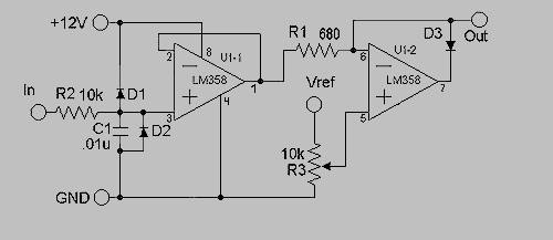

I got this schematic off a site that was last updated about 6 years ago, so i couldnt e-mail the author the question. its for my car, my computer on my car cuts the fuel if boost from the turbo goes beyond 11psi, the MAP sensor tells the computer how much boost the engine is taking in. So if you let the MAP sensor send its normal signal until the voltage for 11psi(around 4.7v) is reached and then make it stay at that voltage the computer wont know you are getting higher boost than 11psi(or whatever you set the clamp to). So this device i posted allows current to pass through normally until the voltage set by R3 is reached and then clamps the voltage at that point.
This voltage clamp is designed to limit the input voltage based on the voltage set by the trimmer at R3 (Vref is 5v input), and then send it to output. But it doesnt limit the input voltage until the set voltage is reached.
Sorry if thats hard to understand cause i suck at explaining things.
But my question is, i dont have a 12v on my application so i really dont need it on the voltage clamp. And i figured since it has a diode that blocks the 12v to the system anyway i could just take it off completely without affecting the performance of the device. So do you guys think it would affect anything?
And also it says "Noise suppression is achieved via the use of a low pass filter on the input, formed by R2 and C1. High frequency roll-off is at about 100 Hz, allowing the circuit to be responsive but effectively suppressing RF noise.", so does the D2 diode have to stay in the schematics for this to work still? Or can it be taken out since the 12v line and diode was taken out?
Here is what i would like to have it set up as
think it will affect it any?
"32", that 12 volt line has to stay there. The diodes are series-connected between +12v and ground so that the voltage on pin 3 of the IC will not be damaged by spikes on the input that exceed the supply voltages on the chip. Your original schematic does not show the ground (pin 4) and Vcc or +12v connections (pin 8) to the IC. So you still need the +12v even if you were to eliminate the voltage clamp at the input. The IC has to have the +12v and ground connections just like your TV set needs to be plugged in to get a TV signal to the tube.
So, leave the original schematic as is and don't forget to add power and ground to the chip connections which are not shown on your skem.

so something like this???
also, im really new to electronics but when reading a schematic and two lines intersect, how do you know if they are supposed to be connected or not???
like between D1 and D2, do those intersecting wires connect to each other? When i added the line from pin 8 to 12v from the IC on the right i put a gap in the line when intersecting the output line to show that it doesnt connect, but thats probably not how you are supposed to do it, so how would you draw that?

LM358 is a dual op-amp, so the supply pin 4 and 8.

I think Sebi was trying to say that since the op amp is a dual op amp, you only need to show the power connections on one of the halves, not both. And traditionally, we put power at the top of the triangle, groung (or negative) at the bottom and leave that left side for the input pins.

Inveterate proofreader that I am, I have to point out that 10k and 0.01uF form a lowpass filter with a corner frequency of about 1.6kHz, not 100Hz as the original designer apparently stated.
Also, if your output needs to be zero when the input is zero, you should add a 4.7k resistor from pin 1 to GND.

Since nobody answered your question about schematics & connection points..
Generally,
1) a net or (line) that ends in a "T" implicitly IS connected.
2) nets that cross are NOT connected. sometimes you see one make a (jump) over the others sometimes not.
3) any net that has a connection "dot" at the points of ambiguity ARE connected. In otherwords, place a DOT to explicitly show connection.
With that said, using the dot method is out of date according to IEEE but my experience is that it is still in wide use. Sometimes the schematic is so garbled looking you can't make out those connection dots. Ever seen a copy of a copy of a copy of a copy? In those cases, understanding of the circuit context is required to assertain connection points that are ambiguous. With printed paper designs declining in popularity, this is less of an issue.

"32", a close look at the pin numbering of the LM358s would show that the two sides used different pins, usually a sure sign that it's a multiple-circuit chip. The other indicator is the chip designators, "U1-1" and "U1-2", indicating that these are two halves ("-1" and "-2") of the same chip (U1). You'll also sometimes see them marked as U1a and U1b or IC1a and IC1b. It all depends upon the person doing the drawing or the CAD program or both.

ok i downloaded Circuit Maker Trial and put the schem in it. everything seems to work good but my output is always .002v higher than the clamping voltage (when it is clamping), and a variable gain of around .02v when not clamping???
when i put that 4.7k resistor in from pin1 to ground it wouldnt work at all

I ran the sim on Linear Technology's SwitcherCAD III, and it worked fine with TI's model, with or without the 4.7k load. With National's model, it wouldn't converge unless I made the load 10k or less. I don't know what the cause of your problem is. Can you post the schematic you used, and whose model you used?
The 2mv offset is built into the op amp models for LM358, as a reflection of the real world. It can be as high as 7mv and still be in spec.

Ok i put it on my car and the 12v keeps zapping the IC. So i ran a simulation with the 12v being 5v instead, and everything worked good in the simulation. But when i built it the output is always around .1v higher than the input :( I think its making the engine run too rich, so is their any way i could add a resistor or something to the output to make it the same as the input???

LM358 output won't go close enough to the positive rail to work with vcc=5V. If you are getting it to go to 4.7v, and you are getting +100mv offset, you probably have a bad op amp. LM358 works up to 32V. If your car battery is killing it, it's probably from huge spikes on the +12V wiring. Add a series 470 ohm, 1/8W (or higher wattage) resistor between the battery and the op amp vcc pin. from the op amp vcc pin to GND, add an 8.2V zener in parallel with a 100uF electrolytic cap and a 100nF ceramic cap. This should clamp and filter out the transients, and also prevent oscillations, which op amps are prone to if the power supply is not decoupled.
could the op-amp be zapped by too high an amperage? The 12v on my car is at 6AMPS. When i was testing it on a computer power supply everything worked fine, but the 12v amps were really low
