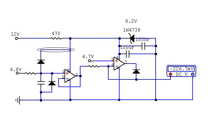

Ok im going to make another one in the future that is better, the one i made works fine but it has about 8 resistors adding up to around 90k of resistance from output to ground to drop the extra .02 volts so im going to figure out the exact resistance i need and use that in the next one. And i want to add what you said to make it more durable to voltage spikes.
but when i put the stuff you said in my circuit maker simulator it didnt work???
i didnt know if the capacitors were supposed to be in series or parallel, but when i tried with them in series it wouldnt even simulate and in parallel i get -226.7mv(note: in the simulator both triangles must be supplied with power and ground)
i couldnt define the capacitors as being electrolytic or ceramic, maybe that has something to do with it???
woops sorry, i flipped the diode around and it works now :)
so that shematic with the diode flipped is what you meant right?

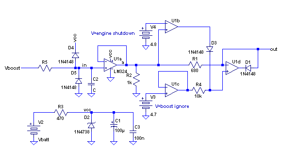

lol also maybe you guys could help me with this, id like to take that circuit and add another trimmer and have that trimmer set a safety point so that if my boost spikes too high it will cut my engine and save it from blowing up. so input = output until voltage at trimmer1 is reached and then it clamps it at trimmer1's voltage but if input reaches voltage at trimmer2 it either clamps it at trimmer2's voltage or just lets input = output again.
sry i keep going on and on with this thread but i dont know much about electronics :(
Yes, flip the zener. And change the connection on the input protection diode as shown below.

oh i forgot, in the simulation i just put a set voltage to pin5 to make it easier to change; i have a trimmer between a +5v and pin5 on my actual board to adjust clamping voltage.
but for the boost protection, this voltage clamp actually makes my motor quite vaulnerable to overboost. the computer gets a voltage from the boost sensor and if it gets to like 4.3v(11 psi) it shuts my engine down, so im putting this clamp in to stop the voltage at 4.25 or so, that way the computer doesnt see past 10.5psi of boost and it wont shut my motor down. so even if im getting 20psi(4.95v) of boost, the computer only sees 10.5psi(4.25v)
the problem is that 20psi will destroy my motor so id like to make the clamp have another trimmer to set to a safety point where it will stop clamping and let "input = output" or "input = safety trimmer's voltage" which will let the computer see the real boost and shutdown the motor.

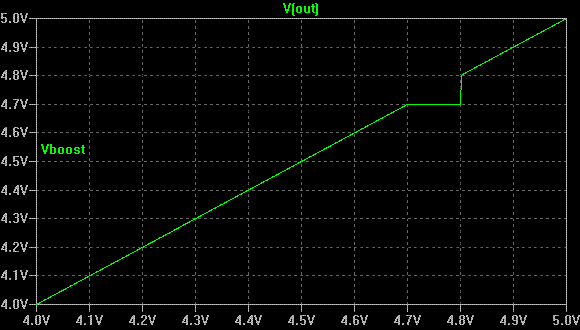

I think the schematic below will do what you want. The transfer function is posted below the schematic. The LM324 is identical to LM358, except it has 4 amplifiers instead of 2.

wow thats awesome, thank you alot. now on to building it lol
ill post back on how things go with it, but it works awesome in my sim
thx again, it does exactly what i need it too :)

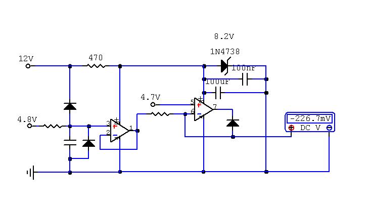

I wired it just like the attached image (post #4). I know this is from about a year ago or more but I was wondering if someone can chime in. My supply is only 5v but everything else is hooked up right. My input is 5v as well. The problem is if i clamp it at 0v i get an output of 1.6v and if I clamp it at 5v it only goes to like 3.something, not sure what i am doing wrong. I see in later posts to maybe flip a diode.

Yes thanks. I hooked it up to a 9v supply now and the device can now out put 1.6-5v instead of 1.6-3.5v. My problem is getting it to go below 1.6v? I saw in a previos post to use a 10k ohm resistor at the output or something and well it does nothing. Thanks for all your input and you long posts, they are very helpful.
Edit: By 1.6-5v (and 1.6-3.5v before I changed the supply from 5v to 9v) I am not altering the input but rather the "clamped" voltage off the potentiometer. Maybe that is my problem and I should put a potentiometer at the input as well and set the clamp to 5v but turn the input down all the way.

Yes since the LM358 that I am using is 1.5v off I think this is my issue. At the input it is always 5v, I am only changing the clamp voltage when I refer to any voltage change. I set the clamp to 0v but the output is still 1.6v which I think is my problem since it will never be clamped this low and that would be the 1.5v offset from ground. I think I need to set it to 0v so the output will be 1.6v but then turn the input to almost 0v as well opposed to the 5v it is constantly set at. Since off the first amp the output will be 5v that when I turn the pot to 0v it tries to get it to ground but it is still a 1.5v offset. I should be changing the input voltage as well. Thanks for the input I will try this out later on when I get home from work.

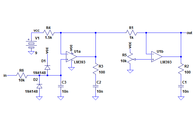

Use an LM393 as an op amp, and it will go almost to zero on the output, because you don't need the diode. The LM393 doesn't have a lot of bandwidth when used this way, but it will still be lots faster than you require.

Hi Ron,
Doesn't the LM393 comparator oscillate when it has negative feedback?
Or does the 10nF with the 100 ohms compensate it?

According to the sim :eek:, it doesn't oscillate with the 100 ohms/10nF. I didn't test it in hardware.
