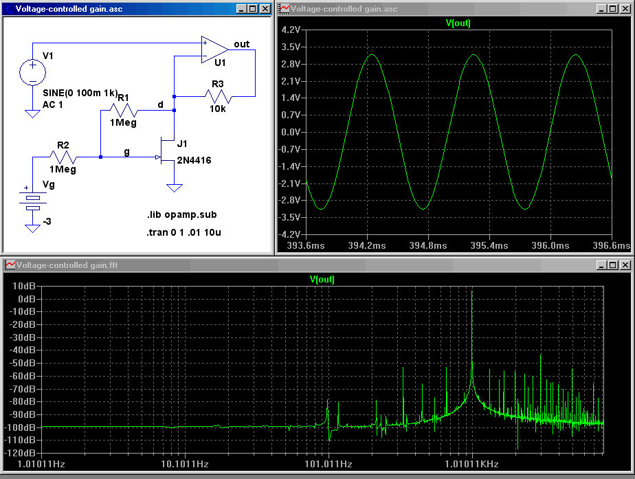

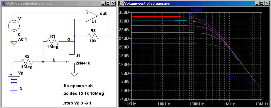

Below are the results of some sims of a gain control in a feedback loop. The top plot shows how the gain varies as Vg is varied. The bottom plot is an FFT, showing about -50dB 3rd harmonic distortion at 1kHz with Vg= -3V (about 30dB of gain). The actual numbers will vary quite a bit from device to device, even within the same part number.
You can also put a resistor in series with the drain to limit the maximum gain, and improve the linearity.
The op amp in the sim is just a simple behavioral model with a gain bandwidth product of 10MHz.
I have no idea how close these results are to reality. :roll:

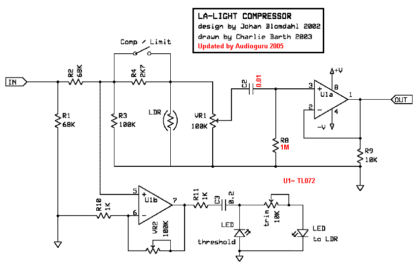

Hi, if you decide to use the LED-LDR idea, try this, here it is implemented in a compressor circuit, but all you need to do is detach the LED, and by applying varying current, different output levels can be achieved with low distortion. Making the LED current high, ie, bright, reduces the level it can pass. It will not go down to full mute however, but do try an ultrabright LED and increase that 2.7K near the LDR to get more level variation at the expense of some distortion.
At a long shot, you could try to modify this for your application, I managed it with the filter schematic:

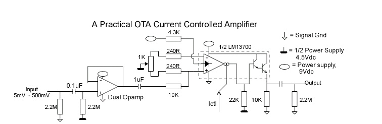

Alternatively, you could try this OTA voltage controlled amp, intended for guitar use, I have no experience with this circuit though:[/url]

It's too bad the author of the LDR attenuator had to use FETs. They aren't needed today since good quality FET-input opamps are inexpensive.
EDIT: The FETs provided some gain. The opamp will have some gain too if you add a resistor between its pins 1 and 2. Am I a poet? :lol:
The LM13700 has a 1:30 attenuator on its input to keep distortion low, so might be noisy. :lol:
