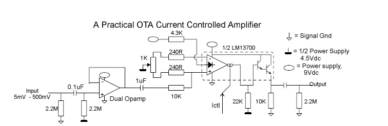

I have one of these:
I haven't actually used it yet, but it should be very good looking at the specs.
You may also find the attached circuit useful, again though, I have no personal experience with it.

ok but i need the data sheet for that part. how does that circuit work there are no pins specified or transistor numbers
https://www.electro-tech-online.com/custompdfs/2005/11/2180data.pdf
That is the datasheet for the part. I'd suggest that using it is the easiest way to approach this problem, its a nice one IC package.
In the other circuit, the transistors you mention are actually inside the 1/2 LM13700; **broken link removed**
Thats why that whole area is surrounded with the dotted box. Ictl is the control current, it will be voltage controlled using a suitable resistor.
