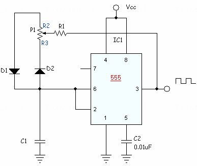

Hi guys, I need a fairly simple circuit, but havent been able to find anything suitable on the net.
I want to control a 12v water pump via PWM, that increases with a 5v signal,
I would like the following options:
able to set (using a pot) what voltage (0-5v) that the pump turns on...
and able to set what voltage (0-5v) that the pump reaches 100% duty...
if anyone could help me out or point me in the right direction it would be much appreciated..
thankyou.
I'm not quite sure if I completely understand what you are trying to do, but I did something pretty similar actually once before. I was controlling a pump's speed based on the output of a 0-10VDC transducer. Based on the output, the pump speed was determined by an AD654 chip, which is a Voltage-to-Frequency converter. Try taking a look at that chip. Hope this helps.
Hi kaido,
you don't require to use 0 to 5V to vary the duty cycle of the circuit. Using variable input voltage requires a pot anyway.
This is contained in the timer circuit already.
Boncuk

hey guys,been overseas and totally forgot about this but yeah. looks like the AD654 is what im looking for! thanks dieplz!
