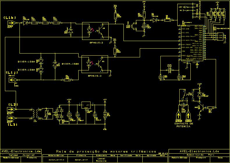

I would like to know if can I use these circuit to measure V-I displacement? The measure will be done in the microcontroller.
Diodos D3,D4,D5 support 10A, that´s the maximum load corrent. I use optocouplers to isolate my circuit.
There are a better approach?
